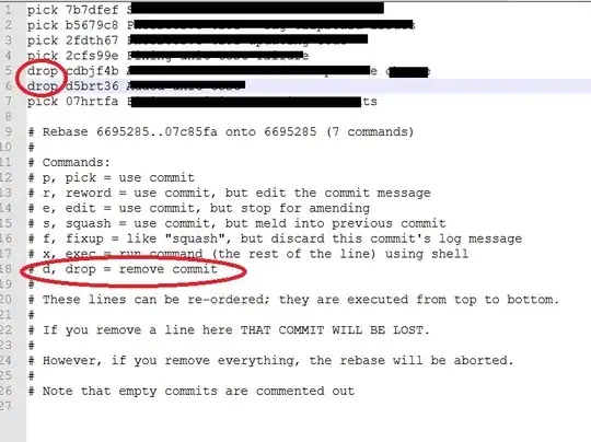

271
Here is an easy solution:
git rebase -i HEAD~x
Where x is the number of commits.
Enter drop before your commit:
And that's it, you are done. If the commit you drop was already on the remote, you will have to force push. Since --force is considered harmful, use git push --force-with-lease.
anon01
  • 10,618
  • 35
  • 58

    For cpp-mentality people: x (no. of commits) is inclusive. e.g. HEAD~4 includes the last 4 commits. – Herpes Free Engineer Feb 14 '19 at 14:24
    perfect suggestion. just want to add, this also discard the changes from the dropped commit. – celerno Mar 07 '19 at 20:35
  • tried to revert 3 commits: git rebase -i HEAD-3 got error fatal: Needed a single revision invalid upstream 'HEAD-3' – Ustin Nov 18 '19 at 19:15
    @Ustin it's ~3 not -3 – JD-V Nov 19 '19 at 05:28
    how to "enter drop"? I can't write anything – Eduard Mar 25 '20 at 16:42
  • Answer to my question above: If you don’t know Vim, just click on each word pick that you want to edit and then hit the key (for insert mode). Once you’re done typing hit the key to exit insert mode. – Eduard Mar 25 '20 at 16:43
  • I also really like this solution, eventho it leaves a trace in the GitHub history. after writing drop on the commits i wanted to get rid of i used :w! and then :q to exit vim. – Petra Apr 03 '20 at 19:12
  • This worked best for me, particularly where I wanted to erase changes to a specific file without deleting it entirely. – rotarydial Jun 23 '20 at 19:18
  • Nice of you to explain vim, but git should automatically use the systems default-editor – tankman175 Mar 14 '21 at 22:18
  • This was the perfect answer for me. Cheers – N Altun Mar 15 '22 at 14:48

Simplest way, Just look for the log and have a count which commits and check out the commit-msg which you want to drop.
Replace x with the count, I will show all the commit-msg, just delete the commit-msg which you want to remove.
# git rebase -i HEAD~x
