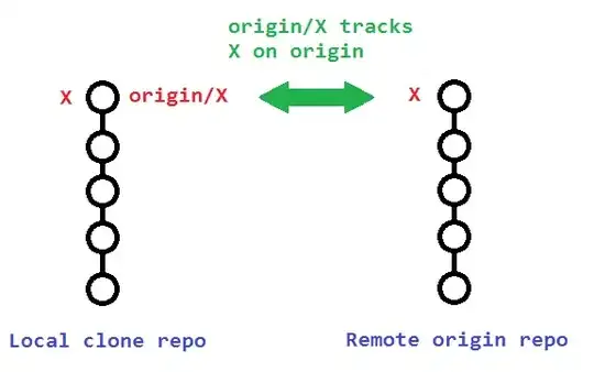

The long answer: there are three different branches to delete!
When you're dealing with deleting branches both locally and remotely, keep in mind that there are three different branches involved:
  1. The local branch X.
  2. The remote origin branch X.
  3. The local remote-tracking branch origin/X that tracks the remote branch X.
Visualization of three branches

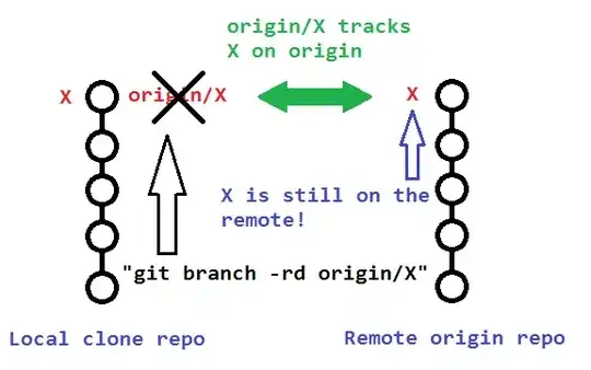

The original poster used:
git branch -rd origin/bugfix
Which only deleted his local remote-tracking branch origin/bugfix, and not the actual remote branch bugfix on origin.
Diagram 2

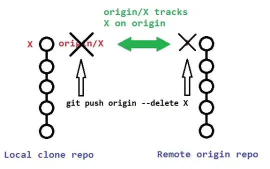

To delete that actual remote branch, you need
git push origin --delete bugfix
Diagram 3
Additional details
The following sections describe additional details to consider when deleting your remote and remote-tracking branches.
Pushing to delete remote branches also removes remote-tracking branches
Note that deleting the remote branch X from the command line using a git push will also remove the local remote-tracking branch origin/X, so it is not necessary to prune the obsolete remote-tracking branch with git fetch --prune or git fetch -p. However, it wouldn't hurt if you did it anyway.
You can verify that the remote-tracking branch origin/X was also deleted by running the following:

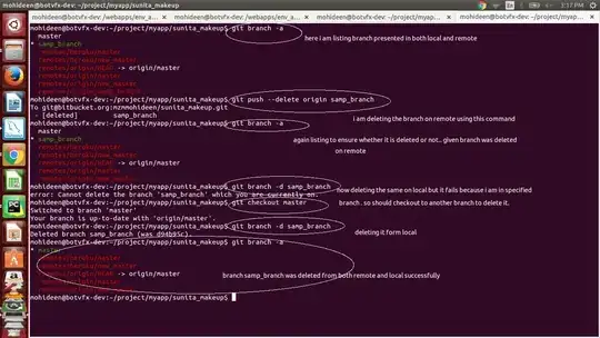

1708
Steps for deleting a branch:
For deleting the remote branch:
git push origin --delete <your_branch>
For deleting the local branch, you have three ways:
1: git branch -D <branch_name>

Graphical representation:
Enter image description here

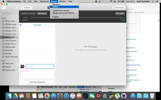

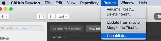

Now you can do it with the GitHub Desktop application.
After launching the application
  1. Click on the project containing the branch
  2. Switch to the branch you would like to delete
    Switching branch
  3. From the "Branch" menu, select, "Unpublish...", to have the branch deleted from the GitHub servers.
    Unpublish branch
  4. From the "Branch" menu, select, 'Delete "branch_name"...', to have the branch deleted off of your local machine (AKA the machine you are currently working on)
    Delete local branch

    I didn't downvote, but my thinking is that it isn't substantively helping. The question is obviously asking for a more commandline type answer without having to use an external program, if people were clicking into here, they likely won't be looking for a github for desktop ways. – Daemedeor Nov 06 '15 at 11:51
    @Daemedeor , I dissagree. In 2010 when the OP asked the question, the UI way of doing it didn't exist and the only option was command line. To indicate that you want a command line only option it should be stated in the question or with the tag, [tag:command-line-interface], which in this case is no present. – Eric Nov 06 '15 at 16:00
    The git command for deleting a remote branch sucks and I tend to forget it (both new and old). Luckily there are GUI tools that have the option. Git Gui, TortoiseGit and GitHub Desktop have it - I wish Git Extensions had this functionality too. Anyway, what I remember is to start Git Gui from within Git Extensions when I need to delete a remote branch. – vezenkov Mar 25 '16 at 21:59

Using Git Bash you can execute the following:
git branch --delete <branch>
Or
From the GitHub desktop application, when you have the branch checked out, you can delete the local branch via the Branch menu strip:
If you are not using the GitHub desktop application and are using an IDE like Visual Studio for your local source control, all you have to do is a couple of quick steps:
  1. Check out a branch other than the one you wish to delete.
  2. Right-click the branch you wish to delete.
  3. Select the Delete option from the context menu.
Then, once logged in to your GitHub account online, go to the repository and click the All Branches tab. From there, just click the little trash can icon on the right on the name of the branch you wish to delete.
*Keep in mind - if the branch isn't published, there isn't any need to try to delete it from your online repository.
Peter Mortensen
  • 30,738
  • 105
  • 131
Uchiha Itachi
  • 1,251
  • 42
  • I don't see these `Overview`, `Yours`, `Active`, `State` and `All branches` tab on GitHub website. Looks like this is an old snapshot. Under the `Code` tab, I see sub-tabs like commits, branches, releases and contributors. When I am the owner of a repository then I see an additional tab named MIT. – RBT Aug 01 '17 at 09:00
  • `git branch --delete ` doesn't delete a remote branch, you need `git push --delete ` to do that – Sheldon Aug 24 '17 at 12:15
