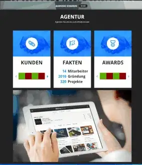

This is the effect I'm trying to achieve with Bootstrap 3 carousel
Instead of just showing one frame at a time, it displays N frames slide by side. Then when you slide (or when it auto slides), it shifts the group of slides like it does.
Can this be done with bootstrap 3's carousel? I'm hoping I won't have to go hunting for yet another jQuery plugin...
