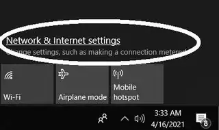

Recently I faced the same problem. When cloning a remote repository I got the error as follows:
fatal: the remote end hung up unexpectedly MiB | 7.00 KiB/s
fatal: early EOF
index-pack failed
When I googled the error I was redirected here. And I followed most of the answers but not solved my problem.
The only solution was to re-install my 'Network adapter (WiFi) driver software'. So, what I want to emphasize is the above error can result from the issues in your PC's WiFi driver software, too. If non of the mentioned answers are not working then you can try reinstalling the WiFi driver. It will solve the issue.
You can easily reinstall the WiFi driver as follows:
  1. Open network and internet settings
    Network and internet settings
  2. Select 'Network reset'
    reset network settings
  3. Then select 'Reset now'
    reset network
After rebooting your pc, try git operations successfully (pushing/pulling/cloning).
