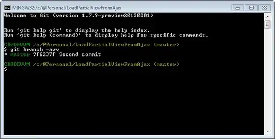

UPDATE
After running the git branch -avv command this is the result

  • What do you get from `git branch -avv`? – ellotheth May 23 '12 at 00:07
  • @ellotheth at what part of the sequence should that be called? – CD Smith May 23 '12 at 01:27
  • @ellotheth Just running it out of any sequence I see master 9f6237f Second commit – CD Smith May 23 '12 at 01:30
  • Anywhere in the sequence. Can you post the whole output? – ellotheth May 23 '12 at 02:22
  • @ellotheth .. that was the whole output – CD Smith May 23 '12 at 02:24
  • @ellotheth I updated question with the screenshot of the Git Bash screen after that command – CD Smith May 23 '12 at 02:27
  • So it was! Ok, do `git fetch origin` and run it again. You don't have the origin/master remote tracker set up, which is probably why the pulls/pushes aren't working. – ellotheth May 23 '12 at 02:31
  • @ellotheth I'd like to start this over from scratch, so I understand the commands and why...in my first set of 1 - 6 above is there anything there that should come out or be modified? – CD Smith May 23 '12 at 02:35
  • Yes: your `git remote add` line should have a -f flag (`git remote add -f yadda yadda`), or you should run `git fetch origin` afterwards. That will create the remote tracker(s) for the remote branches, so `git branch -avv` will show both your local branch and the remote tracking branches (e.g. `remote/origin/master`). – ellotheth May 23 '12 at 02:42
