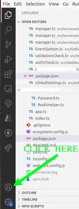

If you had everything automated by vscode before and now it's no longer working, Try signing out of your connected github account on vscode and signing back in to the right github account that has access to that repository.
Here is where you sign out and sign back in.
