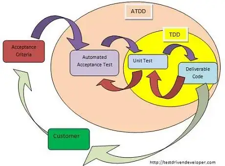

13
By way of illustration:
Note that your QA team is probably working outside the (ATDD) circle, and you are working inside.
I think it is OK to work that way; if you can prove in your automated tests that you are fulfilling the customer's requirements on each sprint, you can allow QA to perform their tests at their leisure, and come to you with defects, which you can then work into the next sprint.
