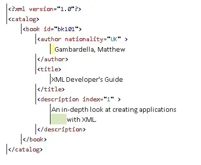

I've written an XML text editor that provides 2 view options for the same XML text, one indented (virtually), the other left-justified. The motivation for the left-justified view is to help users 'see' the whitespace characters they're using for indentation of plain-text or XPath code without interference from indentation that is an automated side-effect of the XML context.
I want to provide visual clues (in the non-editable part of the editor) for the left-justified mode that will help the user, but without getting too elaborate.
I tried just using connecting lines, but that seemed too busy. The best I've come up with so far is shown in a mocked up screenshot of the editor below, but I'm seeking better/simpler alternatives (that don't require too much code).

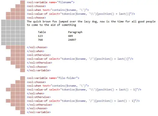

Taking the heatmap idea (from: @jimp) I get this and 3 alternatives - labelled a, b and c:

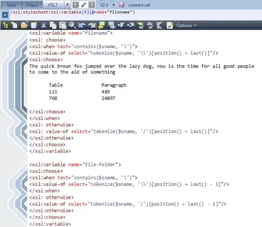

The following section describes the accepted answer as a proposal, bringing together ideas from a number of other answers and comments. As this question is now community wiki, please feel free to update this.
NestView
The name for this idea which provides a visual method to improve the readability of nested code without using indentation.
Contour Lines
The name for the differently shaded lines within the NestView
The image above shows the NestView used to help visualise an XML snippet. Though XML is used for this illustration, any other code syntax that uses nesting could have been used for this illustration.
An Overview:
  1. The contour lines are shaded (as in a heatmap) to convey nesting level
  2. The contour lines are angled to show when a nesting level is being either opened or closed.
  3. A contour line links the start of a nesting level to the corresponding end.
  4. The combined width of contour lines give a visual impression of nesting level, in addition to the heatmap.
  5. The width of the NestView may be manually resizable, but should not change as the code changes. Contour lines can either be compressed or truncated to keep acheive this.
  6. Blank lines are sometimes used code to break up text into more digestable chunks. Such lines could trigger special behaviour in the NestView. For example the heatmap could be reset or a background color contour line used, or both.
  7. One or more contour lines associated with the currently selected code can be highlighted. The contour line associated with the selected code level would be emphasized the most, but other contour lines could also 'light up' in addition to help highlight the containing nested group
  8. Different behaviors (such as code folding or code selection) can be associated with clicking/double-clicking on a Contour Line.
  9. Different parts of a contour line (leading, middle or trailing edge) may have different dynamic behaviors associated.
  10. Tooltips can be shown on a mouse hover event over a contour line
  11. The NestView is updated continously as the code is edited. Where nesting is not well-balanced assumptions can be made where the nesting level should end, but the associated temporary contour lines must be highlighted in some way as a warning.
  12. Drag and drop behaviors of Contour Lines can be supported. Behaviour may vary according to the part of the contour line being dragged.
  13. Features commonly found in the left margin such as line numbering and colour highlighting for errors and change state could overlay the NestView.

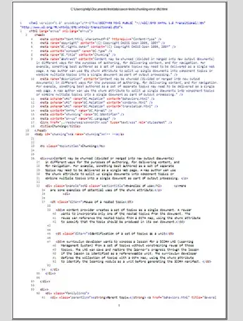

Printing
Indentation will be important for the readability of printed code. Here, the absence of tab/space characters and a dynamic left-margin means that the text can wrap at the right-margin and still maintain the integrity of the indented view. Line numbers can be used as visual markers that indicate where code is word-wrapped and also the exact position of indentation:

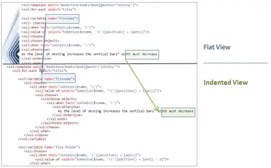

Screen Real-Estate: Flat Vs Indented
Addressing the question of whether the NestView uses up valuable screen real-estate:
Contour lines work well with a width the same as the code editor's character width. A NestView width of 12 character widths can therefore accommodate 12 levels of nesting before contour lines are truncated/compressed.
If an indented view uses 3 character-widths for each nesting level then space is saved until nesting reaches 4 levels of nesting, after this nesting level the flat view has a space-saving advantage that increases with each nesting level.
Note: A minimum indentation of 4 character widths is often recommended for code, however XML often manages with less. Also, Virtual Formatting permits less indentation to be used because there's no risk of alignment issues
A comparison of the 2 views is shown below:
Based on the above, its probably fair to conclude that view style choice will be based on factors other than screen real-estate. The one exception is where screen space is at a premium, for example on a Netbook/Tablet or when multiple code windows are open. In these cases, the resizable NestView would seem to be a clear winner.

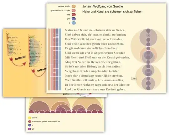

Other Works:
Visualisation of Overlapping Markup
Published research by Wendell Piez, dated from 2004, addresses the issue of the visualisation of overlapping markup, specifically LMNL. This includes SVG graphics with significant similarities to the NestView proposal, as such, they are acknowledged here.
The visual differences are clear in the images (below), the key functional distinction is that NestView is intended only for well-nested XML or code, whereas Wendell Piez's graphics are designed to represent overlapped nesting.
The graphics above were reproduced - with kind permission - from http://www.piez.org

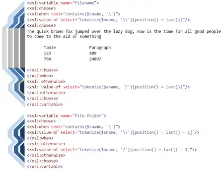

I've attempted to answer my own question here, but this is incorporating the heatmap idea from @jimp and also the 'make it more XML-ish' idea from @Andrea:
Hopefully, the colors in the heat map along with the angular lines help draw the eye between the start and end tags; removing the horizontal line separators improves the 'flow' from start to end. As the user selects with an element the matching part in the heat map can be highlighted in some way - perhaps with a glowing border (as shown).

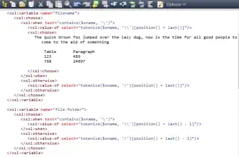

Edit Have decided to go with this, there will probably have to be user options for the colours. A 'production ready' screenshot:
And for comparison...the alternate indented view:

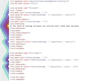

Edit Now, for the more heavily nested case - testing my drawing skills...

    It looks great ! Good job. But how will it look when there is more indentation ? – Loïc Lopes Jun 28 '11 at 09:27
    @Louhike Thanks! Yes, its maxed out at 4 levels and I don't want to stretch the left-margin for more - so I will compress the vertical bars' width increasingly at higher nesting levels - a bit like a contour map hopefully. – pgfearo Jun 28 '11 at 13:50
    @Louhike. I've added an extra image to show how things could look with 9 levels of nesting - after about 15 levels it would probably be necessary to merge the middle bars, perhaps using a gradient fill. – pgfearo Jun 28 '11 at 15:16
    This is simply amazing. +1 for taking code editing and user interface to the next level. Someone with an account should post this to Hacker News, /. or r/programming. – Konrad Rudolph Jun 28 '11 at 15:31

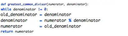

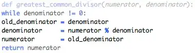

One idea might be to try and add 3D to the text. Increase/decrease the font size based on what level it's at.
For example, this code:
Would look like this:
That might be annoying to work with as it loses fixed text-size-alignment across different levels. Another idea; change the saturation of each level:
How well does that hold up for something really deep? Not sure...

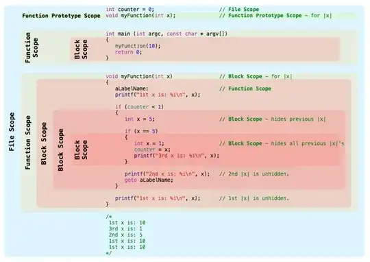

A little while back I did a heat-map showing scope in C. Might be fun to look at for brainstorming:
Aligned-left:

    the heatmap is actually much better at visualizing scope than the left-aligned scope visualization (@pfgearo's solution) – Sandeep Jun 29 '11 at 02:54
  • @Sandeep. I agree that this is in many cases a better solution - especially when reviewing code rather than editing it. Technical constraints (as hopefully explained in the question) make it hard for me to modify the background color with the current control I'm using. Effectively, I've used the left-side of the heat-map in this answer - but with edges sloped towards the edited area to help draw the eye in. One issue with a colored text background is that readability/contrast is lost at higher levels of nesting. – pgfearo Jun 29 '11 at 08:37

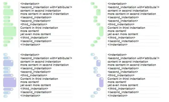

Just tweaking your original idea and switch from squares to capsules. I think these versions (including your original one) are easier to read because they are less complex then the one that shows nesting through nesting the display elements. I think tree elements convey the information in a simpler more intuitive manner.
capsules
I think the left is great for directly showing indentation, while the right is better at conveying a nested relationship.
sbi
  • 9,992
    I prefer the softness of your capsules, however they seem too detached from the text, I need something that is more cohesive and gives a clearer view of what the containing parts are. – pgfearo Jun 28 '11 at 22:25

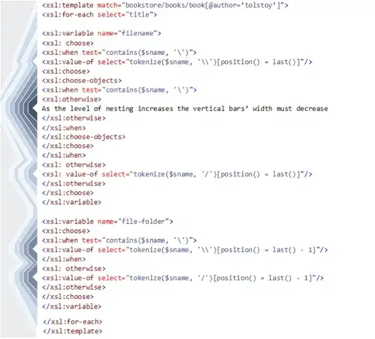

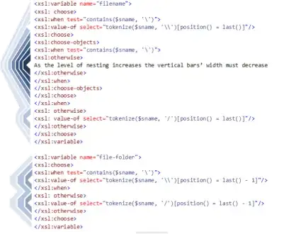

My idea:
The nesting looks more like nesting. The horizontal width of each layer doesn't need to be so wide.
broc7
  • 41
  • I think what you're proposing is essentially the same as the answer (inspired by others) I gave but without the sloping lines. I think sloping lines help draw the eye between the open and close better. Width isn't a real issue because (as shown in the 9-level image) the vertical line width is independent of the sloping line width, so the vertical lines can be compressed. – pgfearo Jun 28 '11 at 17:47
  • Yes, pg- I noticed that after I posted. They're topographically identical- to get fancy about it. It's a matter of taste I suppose, but my version just shouts "nesting" to me in a way your version doesn't. Maybe this feature could sport both and allow the user to choose. – broc7 Jun 28 '11 at 19:14
  • The visual difference between this answer and the OP's answer more than justifies the uniqueness of this solution. And, IMO, this style looks better and conveys nesting more clearly. – SO_fix_the_vote_sorting_bug Apr 11 '20 at 11:26

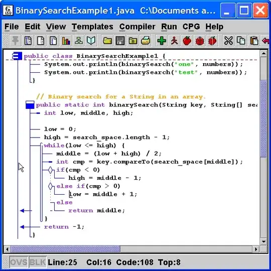

My comments: I have been constantly struggling with the way the Visual Studio IDE does indentation. I would love to use something like this or a variation.
So imagine that link without the lines, and inline with your current xml / code.

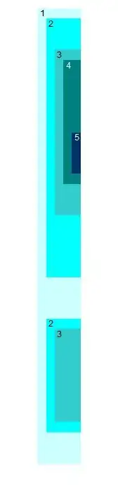

Since you said the visualization must exist in the non-editable (left?) margin, I believe that to mean the visualization cannot be intermingled or behind the code.
Perhaps a heat map in the left column, with brighter colors indicating deeper indentation? Make the margin a fixed size, with a visualization like what you have (expect going left to right like the indentation would) that dynamically uses all of the space given according to the maximum indentation as determined by the DOM depth.

jGRASP does this by using a visual marker in the margin:
It even recognizes when you are using a loop and uses a different type of line to represent that inner loop.
Just thought I would point out how an existing editor does it.
sbi
  • 9,992
ash
  • 121
    Too noisy in my opinion but still a good idea. – Konrad Rudolph Jun 29 '11 at 06:48
  • I've looked this up, and the site documentatin implies that the screenshot is from a code viewer, its a diagram, not a code editor. Also, granted there are no padding characters but its still an indented view. I'm seeking simple solutions that don't required indentation of the code, for the reasons given in the question. That said, JGrasp looks like an excellent tool for improving code comprehensibility. – pgfearo Jun 29 '11 at 23:29
  • JGrasp is supposed to be a code editor at my school we used it in our introduction to computer science class, it was the recommended code editor. It has tools to help compile and run your program, but its not as fancy as Eclipse or Netbeans. But its slightly off from what you described as its not really general purpose and is only really aware of java's syntax. – ash Jul 06 '11 at 04:58
Not a bad idea but having to reference the left margin to clearly see my blocks might get a little annoying. That's not even thinking about screen real-estate or what things might start to look like if the structure gets very deep.
Since the motivation is to help users 'see' the whitespace characters they are using for indentation, you could just show them the white space characters.
I'm not talking special visual characters like paragraph markers, just highlights. Spaces in yellow, tabs in green(or whatever)
For the margin/nesting issue, you could just move the margin for each block in. There is nothing that says the margin has to be a straight line.
I'm sure this is not a new idea.
Something like this:
sample xml showing moving left margin and highlighted whitespace
  • With the indented view the plan is to light up whitespace dynamically, similar to your idea. Also, remember that in a flat view 30 levels of nesting takes up the same space as 1 level, indented, it would be off the edge of your screen, that's one reason why developers are given the choice of views. – pgfearo Jul 01 '11 at 18:30
    Yep that's why I said it wasn't a new idea. However if the level of indent is logarithmic or dynamic based on the level I'm currently editing at you wouldn't have the problem you are talking about. Even if it were just simply fixed at 1 space, it wouldn't be off the screen. You wouldn't be even half way across even an old 80 character display. Yes with some of these ideas 30 levels takes the same space as 1 level, but when you look some of these save no space over just indenting, they just indent the whole thing and add some fancy graphics. – Justin Ohms Jul 01 '11 at 18:40
  • Ohms. There's now a section on screen real-estate in the question (this being a community wiki and all), this includes a screenshot comparison. If you could update this section with your own observations that would be great. Please accept that I'm a mega fan of indented views (working in the XML world and all), that's why I've spent the last 6 months or more perfecting the technique for virtual formatting where indentation is managed by the system. If there's one thing I have learnt though, its that developers like a choice - hence the flat view. – pgfearo Jul 01 '11 at 20:58
  • On first reading, I missed your ideas on dynamic indent widths - this could be a powerful feature. It raises the possibility even of having some code indented whilst the rest is flat, not sure how this would work in practice but its easily tested - with my project, the indent logic is still invoked even for the flat view, its just that the multiplier is set to 0. So its just this multiplier that needs adjusting. Good Call. – pgfearo Jul 02 '11 at 16:13

One option, which could be used in conjunction with the other suggestions so far, would be to use a tooltip on the left margin which shows the path to the line using XPath notation. Browser "inspect element" tools (e.g. Firebug, the one built in to Chrome) often do something similar but in a status bar.
Peter Taylor
  • 4,032
  • 25
  • 29
  • I was just concentrating on this control, but an 'XPath Location Bar' with 'breadcrumb' navigator does work and is incorporated into the editor, as is a synchronised element tree-view. – pgfearo Jun 26 '11 at 09:48
Possibly you could have a collapsed view for the heatmap (from the original post) with only one column of colors and the depth numbers. This would allow them to know how deep they are and give them more screen real estate for the xml. Seems like a win win to me.
I am concerned whether there will be enough color differences to nest things deeply.
m4tt1mus
  • 111
  • Support for high-levels of nesting is a priority. But, there's only so much the eye needs to see (and can take in) at any one time, so beyond a certain level, I'm considering blending colors together, to just give an impression of depth, and only highlighted key levels. So I will check out your idea for when nesting levels are high. – pgfearo Jun 28 '11 at 22:03
