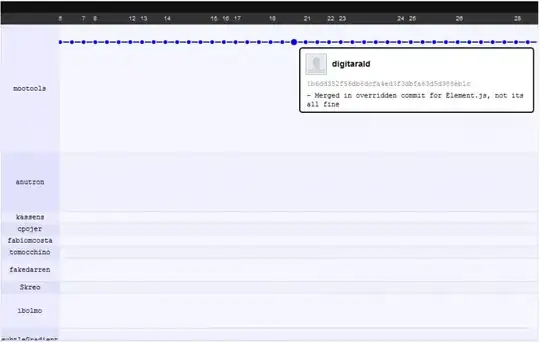

Is it just you?, use a DVCS
As counter-intuitive as it sounds, a Distributed Version Control System (mercurial, git, bazaar)is better to start with than a centralized system (svn, cvs). Why?, you install it on your machine and run your repository locally, and that's it. On a centralized system such as svn you need to set up you client and a server... and then, you need to be connecting to a server to store your changes.
With a DVCS its you, the local repository, and if you want, you can use a service like bitbucket.org or github.com.
IMHO, mercurial is a friendlier and equally capable DVCS to start with.

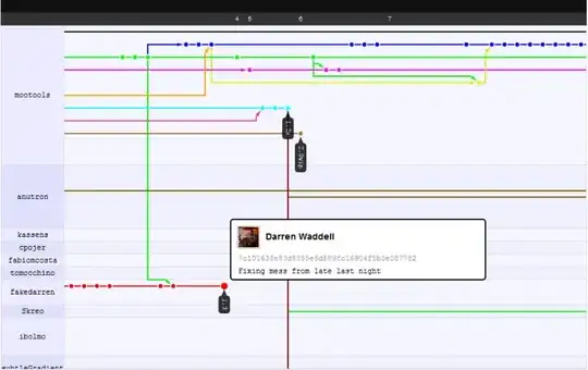

Are there others?, use a DVCS!
There are numerous advantages when using a DVCS for working with a team, the most important one in contrast with a centralized system is that there are no commit races and this is because, technically, each individual's repository is a branch, and when you share your changes those branches are merged for you and you don't even notice, meaning that instead of having a version history like this, where you have people funneling their work on a straight line:
You end up having something like this, where everyone just commits ad hoc:
Each one just worries about their own work while versioning (i.e. not racing to commit) and not worrying about a connection to a server just to commit.

    +1 Very nice examples! You should edit to emphasise the absent pain in complex merge trees with modern tools. – Apalala May 08 '11 at 22:55
