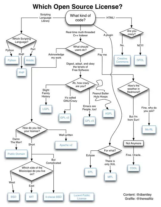

Here's a handy guide:
https://i.stack.imgur.com/GvOBw.png
References to PDF and Graffle versions of above flowchart are available at Karl Fogel's blog.

    [-1]. While I fully understand, that it primarily supposed to be funny rather that informative, I also believe, that it should not contain defects, that may mislead somebody in such a complicated thing as licensing; but it does contain ones. [See next comments] – Dmitry Alexandrov Sep 09 '14 at 16:07
    ① The chart is titled ‘Which Open Source License?’ and infamous 4-clause BSD license is one of the options. But software under the 4-BSDL is not considered so called ‘open source’ by OSI. It is so called ‘free’ accordind to FSF, though, but still is highly not recommended. – Dmitry Alexandrov Sep 09 '14 at 16:07
    ② ‘Creative Commons’ is not a license at all, it’s a foundation, which published a bunch of fundamentally different licenses, which varies form public domain dedication CC0 to ‘free advertising license’ CC-BY-NC-ND, most of them are non-free. – Dmitry Alexandrov Sep 09 '14 at 16:08
  • ③ While the background proposition that when you’re writing something for infrastructure (rather than standalone program) you should apply the license accepted in there, of course, is right, Perl and Mozilla software and not licensed just under Artistic and MPL respectively. Perl is under Artisic or GPLv1+, Mozilla software are under MPL or GPLv2 or LGPLv2.1, where ‘or’ means disjunction of restrictions; so by choosing only one license from the list you fails compatibility. – Dmitry Alexandrov Sep 09 '14 at 16:09
