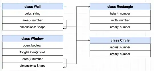

They go on to describe exactly how delegation works. So let’s take a look at their example of how delegation works here. They are saying instead of making a Window a subclass of rectangle, just because the window happens to be rectangular, the Window class might instead reuse the rectangle, and here is the really important part, keeping a reference to the rectangle instance variable and delegating Rectangle specific behavior to it.
For example, instead of making class Window a subclass of Rectangle (because windows happen to be rectangular), the Window class might reuse the behavior of Rectangle by keeping a Rectangle instance variable and delegating Rectangle-specific behavior to it. In other words, instead of a Window being a Rectangle, it would have a Rectangle. Window must now forward requests to its Rectangle instance explicitly, whereas before it would have inherited those operations.
So a Window should have a reference to a Rectangle and they offer a diagram in their book, but I recreated it here: enter image description here
So I said that a Window should have a reference to a Rectangle or generally some kind of shaped object and I can easily swap that object out and that’s how we get code reuse.
SO when the book talks about composition, they are saying, very specifically, we are going to favor delegation as a pattern to implement composition. With this pattern we have some class that has a reference to another object and anytime some request comes in to get the area of the window, the Window class will delegate that calculation off to the outside object.
So that is what the book is saying when it talks about composition.

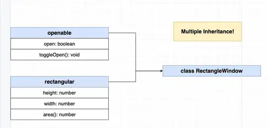

Now here is the important part, to combine or compose them into an object, I would write a single function called buildRectangleWindow that will be called with some state object like so:
const rectangular = (state) => {
    return {
    area: () => {
        state.height * state.width;
const openable = (state) => { return { toggleOpen: () => { state.open = !state.open; } }; };
const buildRectangleWindow = (state) => {};
Now this example is slightly different than the code I got from the blogpost. In the blogpost they define that state object directly inside the function that was intended to actually build an instance of an object, I am going to pass in those instance properties as an argument because that is way more flexible than what the example had.
So then inside of buildRectangleWindow I will say return Object.assign(state, rectangular(state), openable(state));` like so:
    return {
    area: () => {
const buildRectangleWindow = (state) => { return Object.assign(state, rectangular(state), openable(state)); };
I am basically saying take the state object, throw it into openable, when I call openable, it's going to return an object that has some methods on it. Then take the state object and throw it into rectangular and same idea. So essentially this openable is going to return an object that has some method on it, rectangular is going to return an object that has some method on it and then I will take all those different methods and copy paste them down to the state object.
Now, to actually create an rectangular window I would do the following:
    return {
    area: () => {
const rectangleWindow = buildRectangleWindow({ height: 20, width: 20, open: false });
Now to actually use this object, I can do this like:
rectangleWindow.open
To see whether or not the window is open or not and I get false as the output.
I can also do:
rectangleWindow.toggleOpen();
That should toggle the open status and I can print out rectangleWindow again like so:
And now I get true.
So the entire idea behind this approach is that we have these separate definitions of methods and I am going to combine them together to actually build a usable object.
So when all these blogposts are using the term composition, I can buy into that this is some form of composition in the strictest sense of the literal English definition of composition, because we are composing the behaviors of an object by combining them together, but the point is that this is not the same definition of composition as you find in the Design Pattern book and that book is what everyone is quoting.
Erich Gamma and the other authors are extremely smart people who said you should use this pattern right here over class inheritance and then the blogpost authors are saying when they said composition, they meant this thing and that is just not what the authors of Design Patterns are talking about.
Erich Gamma and his co-authors were not saying to do, what I just illustrated in the code above.
This is just not a good pattern and I can show you why this is not a good pattern very easily.
Let’s say for some reason openable also has an area method like so:
    return {
    area: () => {
const openable = (state) => { return { toggleOpen: () => { state.open = !state.open; }, area: () => {}; }; };
rectangleWindow.open rectangleWindow.toggleOpen(); rectangleWindow.open
So, what does that mean? It means that when I have some object that combines the methods from rectangular and openable, which area method are we going to actually get?
The area method we end up getting comes down to the order in which we list them out in the Object.assign() statement.
So this entire pattern here is incredibly fragile. If you ever happen to have any methods with the same name. If you ever do, that’s pretty much it, you cannot combine those different sets of methods together because you are going to get super unexpected behavior.
So the same author of the code, called all this  concatenative inheritance. What it really is, is multiple inheritance like so:
Thats what we are really doing here. We are building up the definition of some rectangleWindow by combining all the different methods that are openable and rectangular. So you can kind of imagine that yep, I am going to copy paste, literally, in this case, all those methods from openable and rectangular down to rectangleWindow.
Again that looks an awful lot like inheritance.
So it is not composition, but multiple inheritance. They are inheriting methods from multiple different sources.
