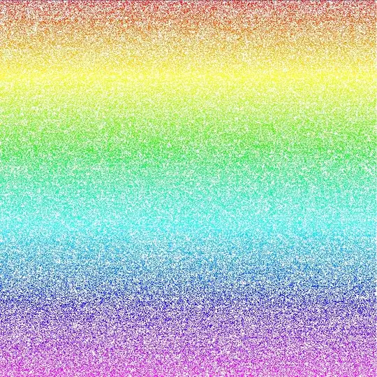

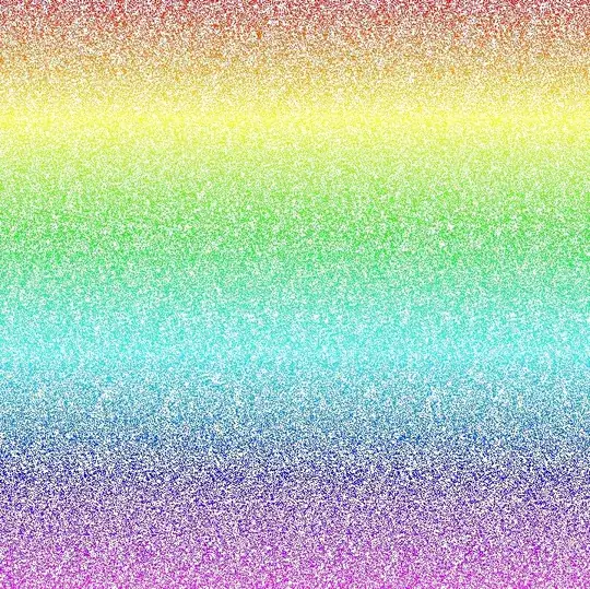

Randomnessification
The other subjective measure is how randomly distributed the hashes are. Mapping the resulting HashTables shows how evenly the data is distributed. All the hash functions show good distribution when mapping the table linearly:
Enter image description here

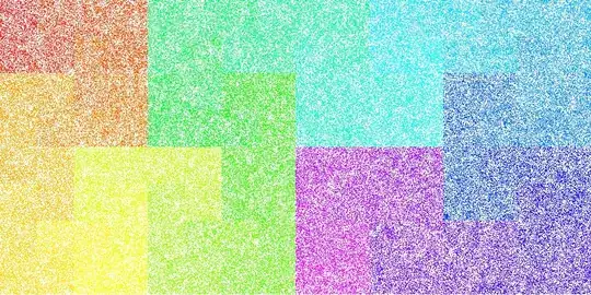

Or as a Hilbert Map (XKCD is always relevant):

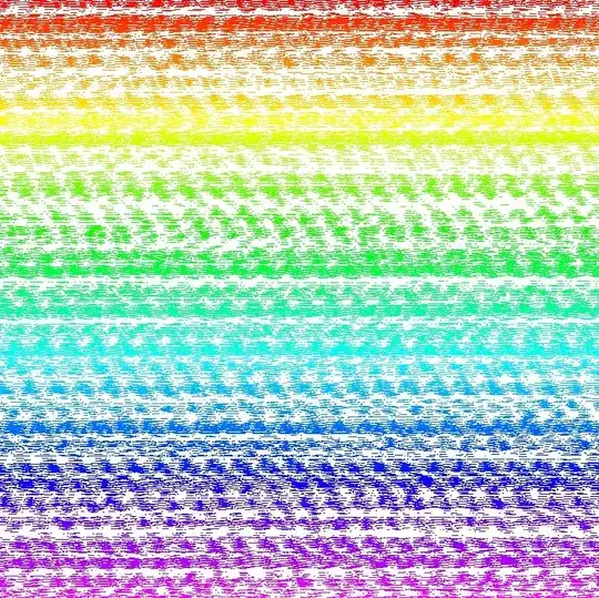

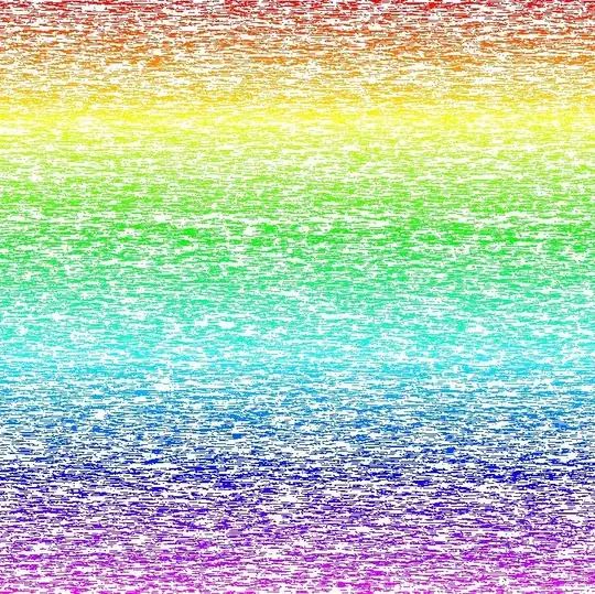

Except when hashing number strings ("1", "2", ..., "216553") (for example, zip codes), where patterns begin to emerge in most of the hashing algorithms:
SDBM:

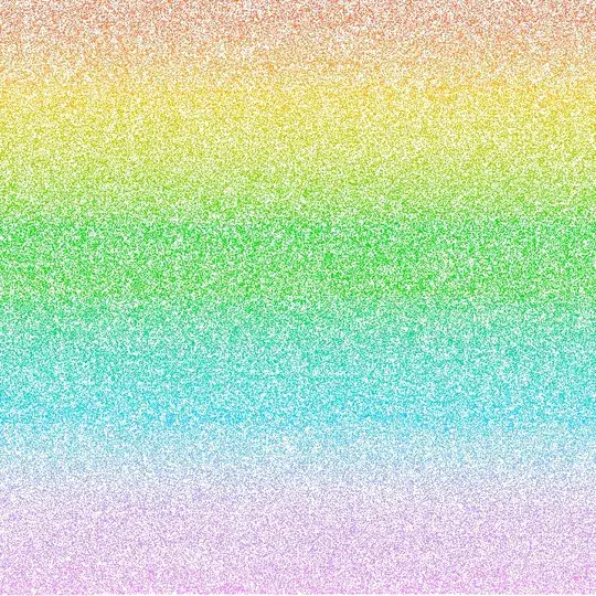

DJB2a:

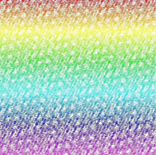

FNV-1:
All except FNV-1a, which still look pretty random to me:
In fact, Murmur2 seems to have even better randomness with Numbers than FNV-1a:
When I look at the FNV-1a "number" map, I think I see subtle vertical patterns. With Murmur I see no patterns at all. What do you think?
The extra * in the table denotes how bad the randomness is. With FNV-1a being the best, and DJB2x being the worst:

    As a random-dot stereogram enthusiast, I had to try viewing your FNV-1a Numbers image as a stereogram. And yes, it is indeed still quite a repetitive pattern for that use case. Treating the image as flowing left to right then top to bottom, I see significant repetition at 805 pixels (is that 805 bits?). 805 = 23 * 7 * 5. I see no repetition in Murmur2. =) – Will Apr 30 '12 at 21:42

  • @IanBoyd - as an aside, do you have a high-res version of the Hilbert Map above? This would made a beautiful addition to this geek's wall art. I'd be willing to pay you for it. – cciotti Dec 01 '14 at 19:19
  • @cciotti I was about to say that i can do that. But then i remembered: that map is 1:1 resolution. There are 216,553 words in the English language, and you see 524,288 pixels (where white is the unfilled hash map). There are no more pixels to show! Were you thinking you'd just like to be able to see a high resolution Hilbert color gradient? 16:10 aspect ratio and 4,000 pixels high? – Ian Boyd Dec 01 '14 at 19:43
  • @IanBoyd - That makes sense. I was hoping to find something high-res that I could print at a reasonable size. I have just the spot and was considering a DNA marker print but I like this too. – cciotti Dec 01 '14 at 19:58

  • The table is very confusing to me. "The extra * in the above table denotes how bad the randomness is. With FNV-1a being..." but the table is under the statement and I don't understand what the '*' mean there... – Noein Nov 07 '15 at 18:39
  • @Noein The * denotes relative badness, with FNV-1 have no "badness", so there is no * next to it. Meanwhile LoseLose is so bad that the ` spill out over the edge of the chart onto the floor. – Ian Boyd Nov 09 '15 at 18:08
  • For the randomness aspect of the two most evenly hashed algorithms, you might look into the Serial Correlation Coefficient (Knuth, pp. 64–65). Applying ent's random analysis on this as a bit stream (rather than byte stream) could be an interesting addition to the analysis. –  Nov 09 '15 at 19:23
    @IanBoyd But FNV-1 has a point, FNV-1_a_ has no points, and CRC has a lot of points while SuperFastHash has none. There's the confusion :/ – Noein Dec 02 '15 at 16:54

  • How do you generate those randomness pixel graphs? I tried calculating SBDM for increasing numbers, then dividing the output of SDBM by 0xFFFFFFFF, and check if its over or under .5 but its almost always under. It looks much worse than your graph. MurMurHash3 works great with my method though. This is my output for SDBM: http://i.imgur.com/MMQuYxY.png – bryc Mar 07 '17 at 04:37
    @bryc Each pixel is an entry in the internal array. If the array slot is empty, it's drawn as white. If the array slot is filled: it's drawn with a color. So then i just create an image that is sqrt(arrayLength) wide and tall. It also helps that, at the time, i was using a prime number probe. I've since switched to linear probe - cause cache hits. – Ian Boyd Mar 07 '17 at 16:06

  • As someone else attempted to say, the FNV-1a diagram does have a pattern to it, it just doesn't repeat on the same frequency as the width of your graph. Do you see the faint diagonal line patterns in the results? If you shift your line length around I believe you will see the pattern become much more pronounced. – Jason Jun 09 '20 at 23:47
  • @Jason I do see them; they're on an angle of around 25°. I'm sure a computer science or math major could write a 4ᵗʰ paper on why the diagonals are there, and come up with the algebraic equation for the exact angle. In the meantime: MurMur2 – Ian Boyd Jun 10 '20 at 01:17
  • I wonder if there's some fast fourier transform people should be doing on scatterplot data to pick the right dimensions. – Jason Jun 10 '20 at 19:02
