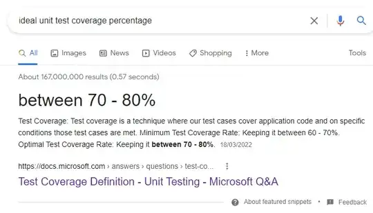

Google tells me that the ideal unit test coverage is 70 - 80% screenshot of Google search result
(although Google's source for that doesn't look especially credible). This old post suggests that in fact it depends on what gives you confidence to release. Which is right?

  • Without clicking the link, I would have thought your "Google tells..." referred to an official recommendation from Google in terms of programming style, but it's actually just referencing a Google search you made that just pulls this number from a Microsoft docs forum. – Tyberius Sep 05 '22 at 13:30
    As a counter point, its possible to achieve 100% code coverage with unit tests while only covering a small fraction of the expected use cases. – Jodrell Sep 05 '22 at 14:56
  • @Tyberius, thanks - I have clarified the reference – OutstandingBill Sep 07 '22 at 22:16
    @OutstandingBill Google searches are not stable over time, location and user. When I click your link, Google actually gives me "95% or higher" as the answer... Might be better to just link to your source directly rather than a Google search that will show very different results to different people. – Marc Sep 08 '22 at 15:32
