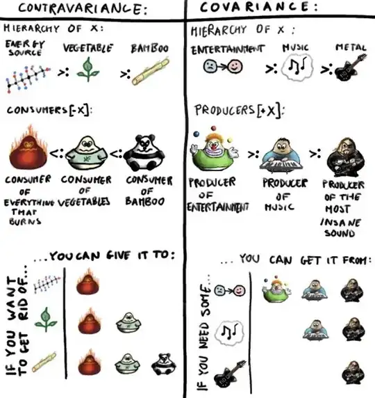

But you don't get that for free. You get that when you carefully design for it. Just because inheritance is happening doesn't mean you can substitute whatever from the hierarchy and get everything you might expect. This issue has been given some fancy names.
Notice these triangles. They come up again later.
It may not be immediately obvious but your polynomial example is a hierarchy. Each term you add is making it more specific and less general. More precisely it's single inheritance. Just by laying out the coeffients in memory in a way where you can find the 0th term in the same place regardless of the number of terms, you will get this kind of single data inheritance (a fancy way to say we know what the number means because of where it is, not because of some label next to it). This lets you reinterpret as a more abstract type simply by looking at less of it. It's the same kind of inheritance that the OSI model uses when building internet packets.
You end up with the same triangle pattern on things you can and can't do (behaviors) with these polynomials if you expose the terms, and for the same reason. Things that only need the 0th term to be there can take any of them. Things that need the 2nd term will get flustered when it's not there.
Now if you don't expose the terms (encapsulate), and instead hide behind an interface (an abstraction) that only promises that evaluate will work then none of that matters. Which is why I hate designs that make me think about contravariance or covariance. I don't need this noise in my life. When faced with this I try very hard to hide the noise behind a simple to use interface. Please do the same for me.
