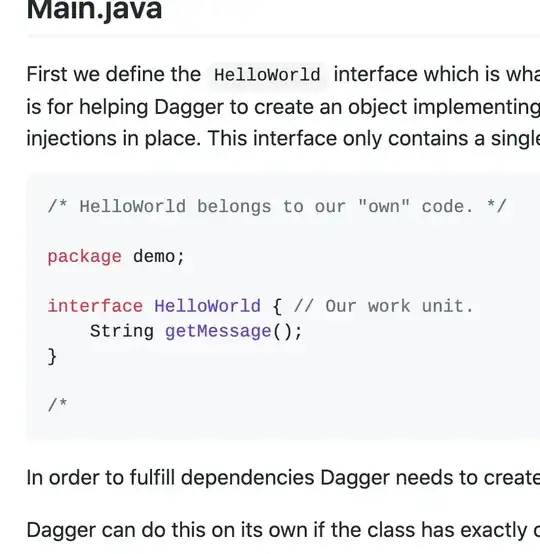

tl;dr - README.md is the modern day heir to literate programming
First of all, Knuth invented literate programming because he needed it for typesetting his books digitally. This was around 1980, making it probably the oldest software package in common use today (not counting mainframes).
As he wanted to teach a subject, elaborate explanation of the actual code was paramount. You most likely do not need this today. Also a lot of the features provided (because the assembly language he used - Standard Pascal - didn't) are now implemented in the languages themselves.
What do we need?
  • Documentation close to the code.
  • Documentation contains live code, not a dead copy.
  • Documentation in a form that is a first class citizen on the web (i.e. usable with a browser)
  • Documentation written in a language that is version control friendly, that is plain text.
GitHub is probably the main stream provider of what we have today which in practical use is the direct successor of literate programming, namely README.md files which are written in the Markdown language, and rendered when navigating the source (this is the really important bit). This allows you to easily document and describe your program, and Markdown is easy to learn. The ability to have the Git repository be both code and documentation is a very important milestone!
Screen shot showing rending of live Java code
I did an experiment to see if I could explain how my "Hello, World!" in Dagger 2 (a Java dependency injection framework) was put together at https://github.com/ravn/dagger2-hello-world as a single file being both Java and Markdown (in the spirit of literate programming) and it came out pretty well. I then learned that the AsciiDoc language can refer to snippets in other files (to get live code in the documentation), but I have not yet tested it fully.
