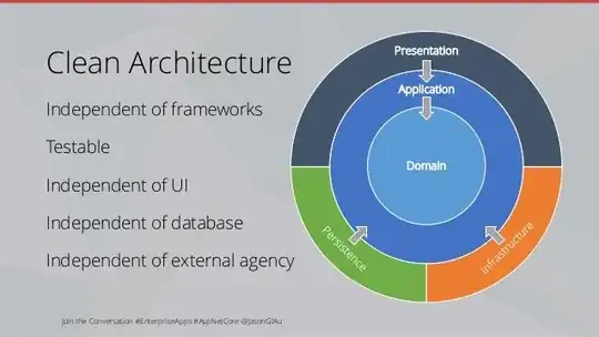

When you look at Clean Architecture diagrams, the DAL is often put on the same level as the top-level consumer (e.g. Web project) since both individually depend on the domain.

Implementing an inverted dependency
So how do we implement this, on a technical level? There are some key points that are different to how you may have been implementing your original "linear sequence" dependency graph. When using an inverted dependency:
  • The domain defines the interface (e.g. Domain.IFooRepository)
  • The domain's logic (e.g. FooManager) has an injected IFooRepository dependency which it operates on.
  • The DAL implements the interface in e.g. Data.FooRepository. It has to fulfill the contract that the Domain demands, which means that the domain forces the DAL to provide all features that the domain uses when interacting with its own Data.IFooRepository
  • The top-level project uses a DI container which registers <Domain.IFooRepository, Data.FooRepository>.
Those are the basic steps to starting with inverted dependencies. For more detailed information, you might want to look up a tutorial online.
