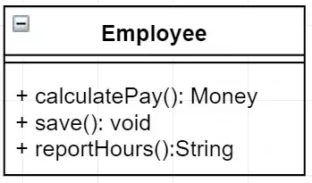

I take the freedom and cite an example from that blog article already mentioned by Christopher:
During a requirements analysis, it is perfectly fine to use a class like this in an UML diagram! So this is a valid "analysis class".
Applying the SRP already on this level of abstraction would often lead to lots of classes with just a single method and no difference between the class name and the method name, so no apparent value.
But when Robert Martin talks about the SRP, he has IMHO the kind of classes in mind which will really occur in code, when these requirements will be implemented. The "analysis class" above is something one would probably not find in Bob Marin's code after he applied the SRP.
Instead, I would expect to find classes in his code like
  • a PaymentCalculator class
  • a whole set of multiple classes for reporting the hours to an ERP system
  • a class EmployeeRepository for saving the employee data to a database, with an interface IEmployeeRepository and maybe mock implementations for testing
  • a sole Employee class for holding the data (and maybe some reusable member function which don't require anything but data members from that class).
Martin's article explains well why it is good idea to separate these different responsibilities into classes to allow maintenance and evolvement of the system, with a lower risk of breaking things when changes have to implemented afterwards. That is where the SRP makes most sense!
