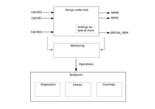

I'm working on a program that tests a digital circuit. The digital circuit can process accesses from multiple different caches, CACHE0, CACHE1, etc. The digital circuit can handle accesses to different memories MEM0, MEM1, etc. and a special kind of memory SPECIAL_MEM. The special memory can be accessed in multiple modes.
Here's a block diagram of my setup: enter image description here
The design under test (DUT) is the digital circuit I am testing.
The monitoring block looks at the input and output signals of the DUT and figures out what kind of access is going on (e.g. from CACHE0 to MEM1). It creates one object for the current operation and sends it to the testbench.
The testbench performs different tasks on the objects it receives:
  • logging of operations that are seen to allow for easy debug
  • checks that certain requirements are met w.r.t. the operations (e.g. that the data written from the cache is the same as the one written to the memory)
  • covers which operations were seen during the test run and stores this information in a special kind of database (e.g. we've seen that we've done accesses from CACHE1 to all memories except to SPECIAL_MEM)
I need to be able to model all types of accesses that can happen. If I think in term of properties that an access has, these are the cache_kind and the memory_kind. When the memory_kind is SPECIAL_MEM, though, there is also the special_mem_mode property. In my real life project there are actually many more properties I need to handle, but I want to keep the example brief and (hopefully) understandable.
Another thing to keep in mind is that in my professional field there is an over-reliance on data objects, as opposed to using objects with polymorphic behavior. You observe the inputs of the digital circuit, waiting for changes that signal a new access, create an object that describes that access and send it to different parts of your program to do different things based on it.
I'm working in an object oriented programming language called SystemVerilog, which borrows a bit from C++ and Java. I'm not sure what the best way is to model my accesses.

    Your question shows research effort, yet I'm reading it and I can't understand what you want to achieve exactly with this interfaces in the first place. It seems to me that you create interfaces for objects that don't have any relation, just to ask them what their type is. Can you please clarify it in your question ? – nadir Jul 19 '19 at 12:25
  • @nadir I've updated the introduction with a bit more information about what I'm doing. I hope this makes my question more understandable. Please let me know if I need to improve it further. – Tudor Timi Aug 08 '19 at 10:51
Interfaces should be used as an API to different users of the class.
You should strive to create an interface that provides a uniform API for the users of objects implementing such interface.
The user should interact with an object implementing interface "A" without caring about the actual runtime type of the object (ideally) or how exactly it implements it.
In how you presented your question, you try to create interface for objects with the sole intention of receiving their data members.
Getting object's data members stands in stark contrast to what I described above - as you are making an assumption regarding the data members of objects implementing the interface.
As you request data members and fields of an object, and not so much care about executing some functionalities on them in a uniform matter - you ask for a specialized API and (essentially) you ask for the specific object type itself (in how you described it).
You should rethink your design. What exactly you try to achieve here, when you create interface to this objects ? (as this is not the use-case of interfaces in OOP)
If you are trying to reuse specific members/implementation details between objects, you can use aggregation/private inheritance and expose what you need.
If you can use the specific object type in your instances of usage, your problem is solved.
The other solutions as you mentioned here ("when" functionality) are to write fat interfaces that divulge a lot of specialized information from the object, or to execute functionality based on RTTI / your implementation to it. Using such things can indicate a bad design (as I noted for you here).
nadir
  • 773
  • I get your points. I guess the main issue stems from the fact that such a design doesn't follow the 'tell, don't ask' principle. – Tudor Timi Aug 29 '19 at 15:35
  • I guess something like the visitor pattern would also be of help here. This seems to fit very well with the example on Wikipedia (https://en.wikipedia.org/wiki/Visitor_pattern). The objects there, Literal and Addition have different data members, but one still would want to "process" them in a generic way. – Tudor Timi Aug 29 '19 at 15:38
  • If you just need to visit and process your entities independently, that is true. Yet, in how you phrased your question it doesn't seem that each entity is independent in its processing (otherwise, why you need to get their specialized data member and invoke specialized routine based on 'when'). – nadir Aug 31 '19 at 18:45
