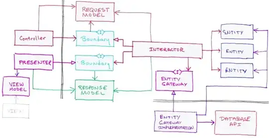

If your programmer tries to invoke SOILD as an excuse for this let me show you a little something from Mr Martin himself:
Note that the models have no interfaces on them at all. That doesn't mean the models will never change. Just preserve the ability to add interfaces later and there's no need to add them now.
The interfaces you do see here are protecting clients from knowing exactly what behavior they depend on across a boundary that is likely to see independent changes. The models have no behavior so the boundary isn't as important to them.

    I first thought you are showing the diagram "ironically", you know, to say: The guy who came up with SOLID also came up with this mess, so let's take these things with a large grain of salt. But then I realized you mean that as a positive example / clarification. So my bad :) – Robert Bräutigam Apr 10 '19 at 11:15
  • @candied_orange just for the record. Open arrows are "use" relationship and closed arrows are "inheritance" relationship. Right? This diagram always bugs me due to so many arrows. – Laiv Apr 10 '19 at 12:04
  • @Laiv Right. --> is using. --|> is just polymorphism. Doesn't really matter what kind. That's used to protect against knowing the implementation of some behavior across a boundary that is likely to see changes. The models have no behavior so no need to protect them like that. The most confusing thing is people expect the arrows to be about flow of control. They aren't. They're about what depends on what. But since flow of control typically goes thru -|> backwords you can figure it out like I showed here – candied_orange Apr 10 '19 at 12:29
