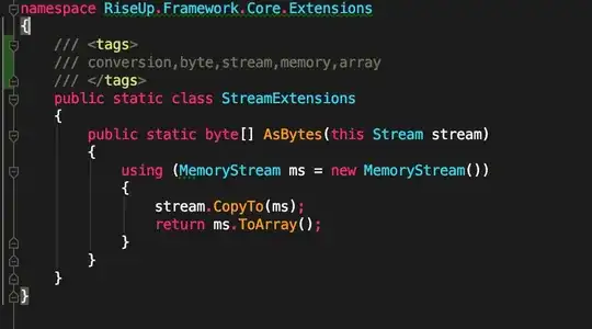

  • We add a series of tags for each class which we consider valuable keywords, like on stackexchange, to help people find the classes they need. Those tags will be extracted because they're documented, and so you should be (haven't tested yet) able to find classes by tags in the docs, or just use Find solution-wide and see the results on the various tags you could type. Exemple in the following image
This is not perfect, it has flaws, but that's where we're at.
