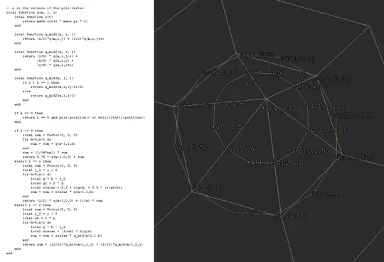

A small sample of my own little notes and "visual babystepping" (I have hundreds of these), and if I'm working from a paper I actually try to match their own diagrams of the intermediate steps of the algorithm to verify that I'm implementing it correctly so far. I have little functions like db_line (draw a debugging line into viewport) along with similar functions to draw labels and points and axes and planes and matrix coordinate systems and such.
Also getting a bit fancy but I tend to prototype these things in script and made it so I can trace through the script line by line and plot what it's doing, one step-at-a-time, into a "debug watch viewport" where I can pan and rotate and zoom around while the script is at a breakpoint to visually examine results as well as plot new things while the script is halted. That might seem a bit overengineered but it was only through building and leaning on tools like this that I was ever able to keep up with the mathematical wizards in my industry. Otherwise I'm the type where if I'm asked to implement an IK solver on a motion hierarchy, I might get the initial implementation 99% correct on the first day only to spend the remainder of the entire week trying to figure out the 1% place where I went wrong in hindsight; with this I can catch those mistakes as I'm making them usually and save so much time.
