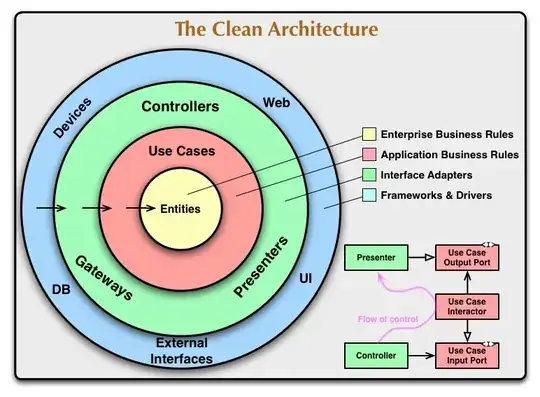

App1 should always reference Core, but Core should never reference App1
That screams plugin.
               AppN       |          Core
    CommonResultUser    -- -|>     IOutputPort
                          |    CommonFunctionality
                          |             _
                          |             V
CommonFunctionalityUser -- -->     IInputPort
The flow of control goes through all of this counterclockwise. Notice all static code dependencies go from App to Core. Core has no idea Apps even exists. Core just provides interfaces that must be used to talk and listen to it.
Construction in main (which knows about everything and nothing else knows about) might look like:
CommonFunctionalityUserInApp1 user =
    new CommonFunctionalityUserInApp1(
        new CommonFunctionalityCore(
           new CommonResultUserInApp1()
Which you are free to shove in a factory, if you feel some need to.
Use might look like:
user.commonProcedure();
And it all might remind you of this:
I'd go on but I've talked about this before.1,2
All this presumes you really do want the AppNs to not be the center of their respective programs and really do want common functionality in your core. Alternatively, common functionality can be moved out into a library.3,4

  • So basically "decouple with interfaces?" – Robert Harvey Jul 29 '18 at 14:51
    @RobertHarvey It's not just about interfaces. It's about what owns them and so dictates if they change. That controls what knows about what. And truthfully you can make this work in languages that have no interface keyword. – candied_orange Jul 29 '18 at 14:57
  • Hmm... Well, I think you got it right with your first sentence: "This screams plugins." Late-binding is the answer; simply instantiate your class without using a static reference. – Robert Harvey Jul 29 '18 at 15:01
