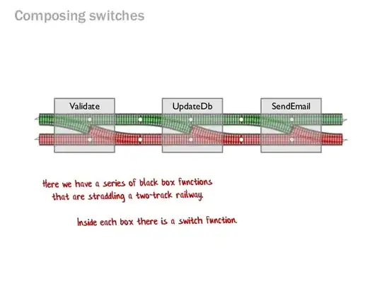

candied_orange
  • 108,538
    Wouldn't it be more appropriate if the red track was below the boxes, thus not running through them? – Flater Jun 04 '18 at 09:33
    Logically, you are correct. However, each box in this particular diagram represents a monadic bind operation. bind includes (perhaps creates!) the red track. I recommend watching the full presentation. It is interesting and Scott is a great speaker. – Gusdor Jun 04 '18 at 10:27
    I guess it is worth adding in the answer that returning error codes will omit the valuable stack trace. Code from OP may not be the problem; but code from other sources will still use Exception and OP will return error code where stack trace data will be lost. Debugging will be very difficult in that case. Great answer by the way; +1 – Amit Joshi Jun 04 '18 at 12:06

The other answers have discussed exceptions vs error codes in sufficient detail, so I would like to add another perspective specific to the question:
OneOf is not an error code, it's more like a monad
The way it is used, OneOf<Value, Error1, Error2> it is a container that either represents the actual result or some error state. It's like an Optional, except that when no value is present, it can provide more details why that is.
The main problem with error codes is that you forget to check them. But here, you literally can not access the result without checking for errors.
The only problem is when you don't care about the result. The example from OneOf's documentation gives:
public OneOf<User, InvalidName, NameTaken> CreateUser(string username) { ... }
... and then they create different HTTP responses for each outcome, which is much better than using exceptions. But if you call the method like this.
public void CreateUserButtonClick(String username) {
    UserManager.CreateUser(string username)
then you do have a problem and exceptions would be the better choice. Compare Rail's save vs save!.
