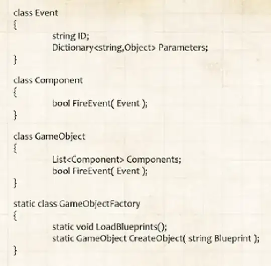

inspired by Brian Bucklew's talk on Roguelike architecture
What Bucklew has done is take all the parameters and methods that we normally enshrine in an interface (thus defining the mini language that client objects use to communicate with their service objects) and he's shoved them all into an event. So now the only thing in the interfaces between objects is the one method that accepts events.
Yet here you are with IsOwnedByPlayerOne(). That's not an event. But you don't have to follow his method.
