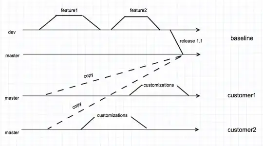

Here is a diagram of how our source control setup is configured.
The issue with this setup is how we handle various customers. I would really like to use a different approach than copying the entire baseline for each of our customers. I think further down the road this will become a major problem to maintain.
How can this be best achieved? Any help insight would be greatly appreciated.

Some options:
  • Put only the customisations in separate repos and just copy them over the original repo when building the deployable. This is only feasible for superficial differences such as theming; once you have code patches in there it very quickly gets unmanageable.
  • Develop separately and merge changes which should be in both repos. This might seem like a good alternative until you have changes which you need to pull apart manually, line by line, to ensure that the repos each do what they want. This work just gets worse and worse with every merge, until inevitably the merges are too expensive to continue. Now everything is duplicate effort.
  • Make the customisations configurable, and put only the configuration in separate repos. This makes it much easier to handle code differences, since they are just feature toggles. The overhead of the switches is much more manageable than the other options unless they go completely out of control (and even then it's generally easier to just prune toggles than to do manual merges forever).

    As @l0b0 notes in each bullet, only the 3rd option is viable.The other two will quickly become unmanageable. – Tasos K. Apr 17 '18 at 07:09

  • The third option is viable. I would not put configurations in separate repositories. I would simply add them to a backed up database or file system. If you want to support thousands of customers, you are unlikely to want thousands of repositories. – Frank Hileman Apr 20 '18 at 01:32
  • @FrankHileman You could easily merge repos as branches if you end up in the enviable situation that managing all the configuration is a chore. But you definitely do want version history, which is cludgy at best in a database. – l0b0 Apr 20 '18 at 02:11
Copying? What do you mean?
If baseline, customer1 and customer2 are different repositories of the same codebase, then just add multiple remotes. For example if you need to work on customer1 code, clone customer1 and add baseline as another remote. Then you can just merge changes from baseline/master into your local product branch, and then push that on customer1/product1 branch. You may merge that back into baseline/master if you want to make some changes common to all your customers.
This way you only have one repo locally, sharing all the common references between your similar repositories.
Don't use customer1/master, as you may have several products for the same customer, so this won't scale, unless you want to store customizations common to all that customer's products.
