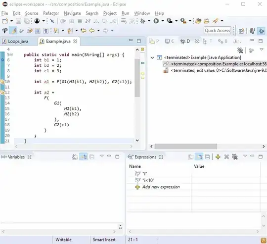

For some reason debuggers love new lines so you should find that debugging this isn't difficult:
If that's not enough, imagine G2() was called in more than one place and then this happened:
Exception in thread "main" java.lang.NullPointerException
    at composition.Example.G2(Example.java:34)
    at composition.Example.main(Example.java:18)
I think it's nice that since each G2() call would be on it's own line, this style takes you directly to the offending call in main.

  • Agree, but (1) forecast(precipitation(temperature(b1), humidity(b2)), dewPoint(c1)) tells the same story, if you name your function appropriately. (2) Debuggers show the stack trace too, you can identify the scope easily. – coredump Feb 23 '18 at 14:32
  • “A debugger is only going to highlight the whole thing at once.” — That very much depends on the debugger. It’s been a while since I used VS (which is presumably what OP uses) but as far as I can remember the debugger deals just fine with subexpressions. – Konrad Rudolph Feb 23 '18 at 15:10
  • @KonradRudolph well theoretically you're right of course. To which I say: "Pics or it didn't happen!" – candied_orange Feb 23 '18 at 15:33
  • @CandiedOrange Best I can find in a pinch (note the highlighted sub-expression). In addition sub-expressions can be inspected/computed and, IIRC, have break points set on them. – Konrad Rudolph Feb 23 '18 at 15:42
  • @KonradRudolph nice! Hmm I think we're taking down 2000things.com with all the traffic. Failing to load. – candied_orange Feb 23 '18 at 15:56
  • @KonradRudolph In your second image, it's only showing the value of i, which is a specific variable. I don't think it will show the return value of a function that's not assigned anywhere. You could invoke it via Immediate Window, but if it's an expensive function, you might not want to do that, and for some functions, Immediate Window sometimes just kind of craps out and fails. – jpmc26 Feb 23 '18 at 21:41

Regardless if you are in C# or C++, as long as you are in a debug build, a possible solution is wrapping the functions
var a = F(G1(H1(b1), H2(b2)), G2(c1));
You can write oneline expression, and still get pointed where the problem is simply by looking at the stack trace.
returnType F( params)
    returnType RealF( params);
Of course, if case you call the same function multiple times in the same line you cannot know which function, however you can still identify it:
  • Looking at function parameters
  • If parameters are identical and the function does not have side effects then two identical calls become 2 identical calls etc.
This is not a silver bullet, but a not so bad half-way.
Not to mention that wrapping group of functions can even be more beneficial for readability of the code:
type CallingGBecauseFTheorem( T b1, C b2)
     return G1( H1( b1), H2( b2));
var a = F( CallingGBecauseFTheorem( b1,b2), G2( c1));
