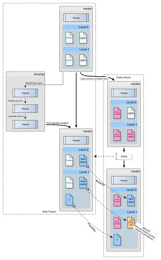

Since I'm better with visual representations, I basically want to get this done:
what I want
I did some searching and could only find this Git: Branch or Fork? And this one A decent git branching model for products that should accompany the version of another, third-party product (and pros and cons of one proposal)
But while a similar situation, those questions neither got any concrete answers.
Initial, it seemed as easy as creating a fork, but it seems you can't fork your own repos.
I then thought "Fancy House" could simply be an eternal branch, but on multiple occasions people have advised against that, saying branches are intended for temporary development and should always be used to eventually merge back into the master branch. Also, releases are awkward to handle and having a "true master" and "fancy house master" branch would cause further awkwardness and possible confusion (and only one of them being allowed to be truly the default branch).
I ran a quick test of the so called "submodules", but that seems to create a folder within the repo (so "Fancy_House/House_Project/House/Lights.txt"), which doesn't really work and messes with the folder structure (making "New & Fancy Lights.txt" not possible), and it also adds the main repos readmes and such, further clogging up the spin-off repo with unneeded stuff.
Similarly, a pull request from one repo to a different repo would also do the trick; but that's not possible to do either.
Of course, it is not absolutely impossible to simply manually copy over the changes and commits from the main project over to the spin-off; but that does mean all commits and history are being lost and requires manually doing so, which can be especially annoying if lots of small fixes are being added to the development branch. Possibly using the submodule function just so it's right there in your face and you don't need to change repos...still really annoying workaround.
We tend to exclusively use either GitHub desktop or GitKraken, if this helps at all.
I might be completely oblivious to something obvious though; which is why I'm asking here.
