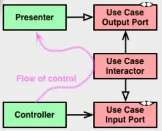

How much can we get done without getters? Is it possible to completely remove them? What problems does this create? Could we even ban the return keyword?
It turns out you can do a lot if you're willing to do the work. How then does information ever get out of this fully encapsulated object? Through a collaborator.
Rather than let code ask you questions you tell things to do things. If those things also don't return things you don't have to do anything about what they return. So when you're thinking of reaching for a return instead try reaching for some output port collaborator that will do whatever is left to be done.
Doing things this way has benefits and consequences. You have to think about more than just what you would have returned. You have to think about how you're going to send that as a message to an object that didn't ask for it. It might be you pass out the same object you would have returned, or it could be simply calling a method is enough. Doing that thinking comes at a cost.
The benefit is that now you're doing your talking facing the interface. This means you get the full benefit of abstraction.
It also gives you polymorphic dispatch, because while you know what you're saying you don't have to know what exactly you're saying it to.
You might think this means you have to go only one way through a stack of layers, but it turns out you can use polymorphism to go backwards without creating crazy cyclic dependencies.
It might look like this:
Enter image description here
class Interactor implements InputPort {
    OutputPort out;
    int y = 0;
    Interactor(OutputPort out){
        this.out = out;
    void accumulate(int x) {
        y = y + x;
        out.showAsImage(y);
If you can code like that then using getters is a choice. Not a necessary evil.
