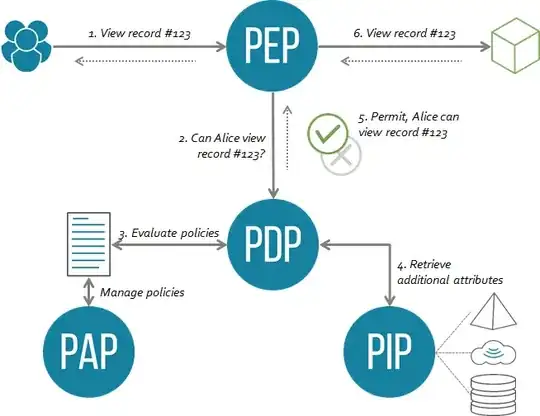

ABAC also defines an architecture and an authorization flowThe ABAC / XACML Architecture:
  • the Policy Enforcement Point (PEP) is the interceptor which protects your application
  • the Policy Decision Point (PDP) is the authorization engines which decides whether access should be granted
  • the Policy Information Point (PIP) is the place where metadata is stored e.g. an LDAP or an application database. If we need to know the patient's assigned doctor, this is where we read it.
  • the Policy Administration Point (PAP) is the interface through which policies are centrally managed.

XACML inherits ABAC's architecture (see above) with the same components. It also defines a way to query for authorization. A request is also made up of attributes. For instance:
  • Can Alice view medical record #1?
  • Can the user with ID="Alice" do the action="view" on object of type="medical record" with objectId="1"?
The answer is one of four possible decisions: Permit, Deny, NotApplicable, or Indeterminate. Along with the decision, you can also return statements that enrich the flow. For instance, deny + obligation to notify the user's manager about the denied access.
