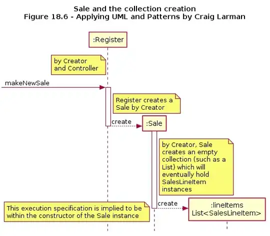

If your method is really doing something not obvious, a UML note would be a good way to show those things, just as line comments are used in a programming language. Here's an example from Craig Larman's Applying UML and patterns book:
