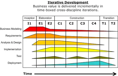

I think the image on the Wikipedia article is a pretty good representation of the process framework.
Rational Unified Process
Your four phases - Inception, Elaboration, Construction, and Transition are sequential. In a given project, you'll be in each one once. However, in each phase and within each iteration of a phase, you'll spend different amounts of time in the 9 (6 engineering and 3 supporting) disciplines.
You can see this in the diagram. Although some aspects aren't shown. For example, the diagram only shows one Inception iteration, but there could be many. Some disciplines lend themselves better to Inception than other disciplines - for example, Project Management, Business Modeling, Requirements, Environment, Configuration Management. The Inception phase has criteria for completion - agreed upon scope, primary use cases identified, a managed development process, project plan baselines, etc. Each iteration could have a different emphasis on work that needs to achieve the completion criteria, meaning the types of and effort put into the disciplines will vary within each iteration.
The same applies to the Elaboration, Construction, and Transition phases. Each one could have one or more iterations that show progress toward the end goals of that phase.
