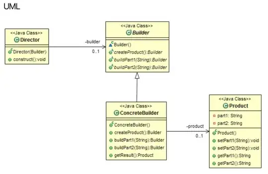

UML of Builder Pattern:
UML of Builder Pattern of GoF
Reference design-patterns-stories.com
I've read the book of GoF about builder pattern again and again, the followings are some of my notes:
  • Director :
    • A director can be reused.
    • And it contains the algorithm(s) to build a product, step by step.
    • Use the interface provided by Builder.
    • Logically, it create the product.
  • Builder :
    • A builder should be general enough (to let almost any possible different ConcreteBuilder to build their corresponding product. This is the origin of my second question below.)
  • ConcreteBuilder :
    • A concrete builder builds all the parts needed, and know how to assemble them.
    • And keeps track of its product. (It contains a reference of its product.)
    • Client get their final product from a concrete builder. (It's ConcreteBuilder who has the getProduct() method, Builder don't have getProduct() (abstract) method.)
  • Product :
    • It's the complex object to be built. For every ConcreteBuilder, there is a corresponding Product. (This is the origin of my first question below.)
    • And it provide the interface for its corresponding concrete builder to build the logical parts and to assemble them.
    This is why people confused about Bloch builder and builder pattern of GoF. Bloch builder just makes the interface easier to be used by the concrete builder. (Btw, how to indent this line...)
  • The client :
    • Choose a concrete builder he needs. (Implementor)
    • And choose a director he needs. (Logic)
    • Then inject the concrete builder into the director.
    • Call director's construct() method.
    • Get the product by calling getProduct() of concrete builder.

The GoF Builder pattern is one of the less important patterns suggested in the Design Patterns book. I haven't seen applications of the pure GoF Builder pattern outside of parsers, document converts, or compilers. A builder-like API is often used to assemble immutable objects, but that ignores the flexibility of interchangeable concrete builders that the GoF envisioned.
The name “Builder Pattern” is now more commonly associated with Joshua Bloch's Builder Pattern, which intends to avoid the problem of too many constructor parameters. If not only applied to constructors but to other methods, this is technique also known as the Method Object Pattern.
The Go4 Builder Pattern is applicable when:
  • the object cannot be constructed in one call. This might be the case when the product is immutable, or contains complex object graphs e.g. with circular references.
  • you have one build process that should build many different kinds of products.
The latter point is the key to the GoF builder pattern: our code isn't restricted to a specific product, but operates in terms of an abstract builder strategy. An UML diagram for a Builder is very similar to the Strategy Pattern, with the difference that the Builder accumulates data until it creates an object through a non-abstract method. An example might help.
