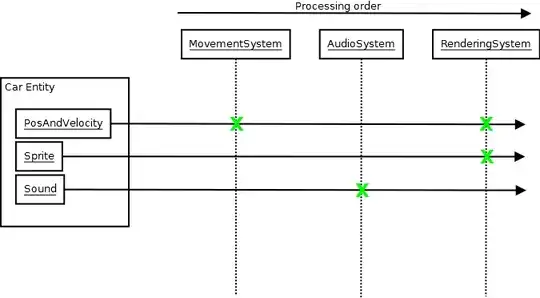

Embedded Scripting
This is really for larger scale codebases but another technique I find immensely useful is to use an embedded scripting language for at least the most high-level parts of your system. I found I was able to embed Lua in a day and have it uniformly able to call all commands in our system (the commands were abstract, thankfully). Unfortunately I ran into a roadblock where the devs distrusted the introduction of another language and, perhaps most bizarrely, with performance as their greatest suspicion. Yet while I could understand other concerns, performance should be a non-issue if we're only utilizing the script to invoke commands when users click buttons, for example, that perform no hefty loops of their own (what are we trying to do, worry about nanosecond differences in response times for a button click?). So that might not be so applicable to you but it's an option I'd consider for larger codebases focusing more on the issues of build times than the other issues associated with "header spaghetti", since it can eliminate a lot of what might otherwise need to be pre-compiled and linked (nowadays I write even all my integration tests in high-level script which is a load off on the build system and CI).
Example
Meanwhile the most effective way I've ever witnessed after exhausting techniques to reduce compile times in large codebases are architectures which genuinely reduce the amount of information required for any one thing in the system to work, not just decoupling one header from another from a compiler perspective but requiring the users of these interfaces to do what they need to do while knowing (both from a human and compiler standpoint, true decoupling that goes beyond compiler dependencies) the bare minimum.
The ECS is just one example (and I'm not suggesting you use one), but encountering it showed me that you can have some really epic codebases that still build surprisingly quickly while happily utilizing templates and lots of other goodies because the ECS, by nature, creates a very decoupled architecture where systems only need to know about the ECS database and typically only a handful of component types (sometimes just one) to do their thing:
