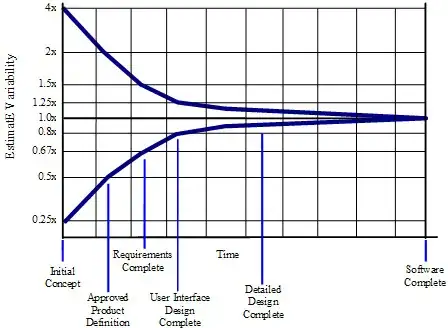

Doesn't answer the question exactly, but here are some ideas that are closely related:
The Cone of Uncertainty
Link
Early in a project, specific details of the nature of the software to be built, details of specific requirements, details of the solution, project plan, staffing, and other project variables are unclear. The variability in these factors contributes variability to project estimates -- an accurate estimate of a variable phenomenon must include the variability in the phenomenon itself. As these sources of variabiility are further investigated and pinned down, the variability in the project diminishes, and so the variability in the project estimates can also diminish. This phenomenon is known as the “Cone of Uncertainty” which is illustrated in the following figure. As the figure suggests, significant narrowing of the Cone occur during the first 20-30% of the total calendar time for the project.
Cone of Uncertainty

  • The cone of uncertainty (at least as presented at that site) implies you should do a detailed design as early as possible to reduce risk. Agile considers this a misconception. –  Oct 29 '16 at 07:22
  • @dan1111 the Cone of Uncertainty applies just as well to a Scrum iteration as it does to an entire waterfall project. – RubberDuck Oct 29 '16 at 09:44
