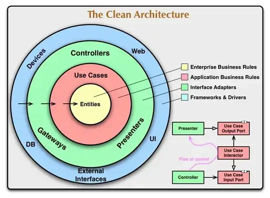

A DDD system can have an architecture that looks like this:
This architecture goes by a lot of names: Clean, Onion, Hexagonal, etc
Here's the disconnect I see many people have when they look at this design. This isn't concrete. I can follow this design and never have written anything you see diagrammed here. I see others insist there must be a use case object or an entities class. What these are is a set of rules that tell you who you can talk to and how.
That's it. Follow the rules of this design and you can TDD your little heart out. TDD doesn't care who you talk to. It cares that everything that does something can be proven to work or not at the click of a button. Not, something somewhere is broken. It tells you exactly what's broken.
Still to vague? Look at the Controler - Use Case Interactor - Presenter diagram in the lower right corner. Here are three concrete things communicating with each other. Sure this is DDD but how do you add TDD here? Just mock the concrete stuff. Presenter must be receiving information. A PresenterMock class would be a good way to check that it's getting what you expected it to get. Hand the Use Case Interactor the PresenterMock and drive the Use Case Interactor as if you were the Controller and you have a nice way to unit test the Use Case Interactor since the mock will tell you if it got what you expected it to get.
Well look at that. TDD satisfied and we didn't have to futz with our DDD design. How did that happen? We started with a well decoupled design.
