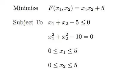

Engineering problems often have limitations imposed on the system. These may be the result of resource limitations such as geometric constraints, physical limitations, or other sources. Continuing the example of a pop can, constraints might be a maximum total cost, a target can volume, or a target diameter to height ratio. Constraints are reflected in optimization problems through numeric equations or computational routines.
An example constrained optimization problem is shown below:
There are three primary types of constraints within optimization problems - inequality, equality, and side. The example contains a single inequality constraint (x1 - x2 -5 <= 0), a single equality constraint (x1^2+x2^2 - 10 = 0), side constraints for both x1 and x2, and a total of two design variables.
Inequality Constraints
Constraints expressed as inequalities are simply referred to as inequality constraints. The inequality constraint above would be x1+x2 -5 <= 0.
Inequality constraints are usually converted to be of the form g(x) <= 0 and normalized. In a generalized case, inequality constraints within optimization are represented by:
  • gj(x) <= 0 j = 1,...,m
where j represents each of m constraints, and x is the independent design variable vector.
When a constraint g(x) = 0, the constraint is considered to be an active constraint. When g(x) < 0, it is considered a satisfied constraint.
Equality Constraints
Equality constraints are similar to inequality constraints, except of the form h(x) = 0.
The equality constraint from above is
  • x12+x22 - 10 = 0
Generally, equality constraints are represented with a small tolerance to help optimization methods obtain feasible solutions.
Side Constraints
Side constraints are lower and upper bounds for the independent design variables. From above, side constraints are
  • 0 <= x1 <= 5
  • 0 <= x2 <= 5

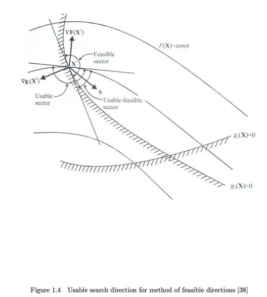

While the previous section discussed modifications to problem formulation allowing unconstrained methods to be applied to problems containing constraints, another class of methods deals directly with constraints. Direct methods tend to be efficient and offer improved precision but generally require solutions to remain feasible and both constraints and objective functions must be composed of differentiable functions 1.
One of these methods is the Method of Feasible Directions. Heavily relying on gradients, this method identifies a region within the design space a point can move to reduce the objective function and remain feasible 1. Iterations progress by forcing the design point to consistently decrease in fitness while remaining feasible. This is shown in Figure 1.4 (Vanderplaats) The usable-feasible sector represents the area the current design point can move and simultaneously decrease the objective function and satisfy constraints.
The Generalized Reduced Gradient method effectively converts all constraints into equality constraints by adding variables called slack variables to all inequality constraints. It then uses gradients to calculate a reduced gradient and performs a 1-D search (see Vanderplaats for more information). The basic search logic for the General Reduced Gradient is shown in Figure 1.5.

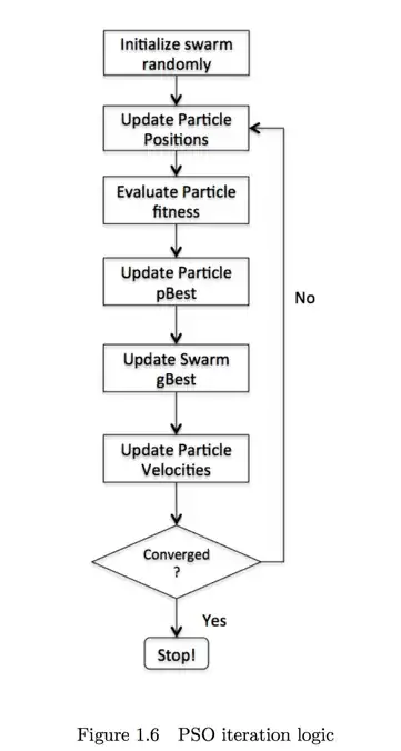

The basic format for each PSO iteration is shown in Figure 1.6. After random initialization, particles first move to different design points within the design space. Once particles move, fitness is evaluated and pBest each updated. The swarm gBest is then updated and each particle velocity calculated for the next iteration. Position and velocity are updated using update Equation 1.7 through Equation 1.9.

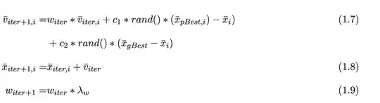

Equation 1.7 is the velocity update equation. This determines the new velocity for each particle i for the next iteration (viter+1, i). The current velocity (viter, i), current particle location (xi), and current gBest and pBest locations (xgBest and xpBest) are used to calculate the new velocity. Parameters c1 and c2 are user defined and typically set to 2.0 5. The particle moves each iteration according to Equation 1.8.
Figure 1.7 (Kalivarapu8) shows how the components of the velocity update affect the particle's location each iteration.
In order to facilitate convergence and better allow exploration during initial iterations, Equation 1.9 represents an inertial weight affecting velocity (witer). As iterations increase, the effect of lambdaw causes velocity to be slowly damped throughout iterations as it is typically a value slightly below 1.0 6. Additional discussion on the inertial weight factor can be found in 7.
Convergence criteria are user defined and checked each iteration. An example is having 50 sequential iterations with no more than 0.0001 improvement in gBest.
