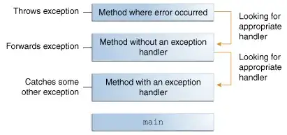

When an exception is thrown, the framework will walk up the call stack until it finds an exception handler that handles the type of exception you threw. If there is no such exception handler, the program ends. So you can provide an exception handler anywhere in the call stack where it is convenient to put one.
In general, exceptions should be used for situations that your code cannot do anything about or recover from without user intervention. If your user provides a file name that does not exist, for example, your code cannot read the mind of the user to get the correct file name, so it throws an exception.
The difference between throw and throw new is that throw new throws a new exception, while throw is used when you want to catch the original exception, do something with it (log it perhaps), and then rethrow it so that it continues to bubble up the call stack while preserving the original stack trace.

As your program executes, it progresses from one function to another. This eventually builds a path from the entrypoint to the current execution point in the program. The code itself is largely unaware of what function called it.
This leads to problem when things go wrong. When things go wrong in a function, it doesn't know who called it, so it doesn't really know what to do. Enter exceptions. Exceptions are there for the function to say "oh shit, something went wrong! I don't know what to do! I hope the stuff that called me knows what to do...".
What happens is that a function throws an exception, and then the computer goes back along the path of execution that the program built up until it finds some function that actually knows what to do. If no function is found, the OS generally just kills your program because something went horribly wrong.
That's exceptions in a nutshell.
In C#, the throw statement is how you tell the function to fire off that exception and go back along the execution path. The common usage of the statement takes an Exception object as an argument. Since you almost always have a new Exception, that's why you use new - just like any other object.
catch is how you tell the computer "I know how to deal with this sort of error if it happens here".
  • The current statement block terminates immediately where it is, and checks if there's a catch block in it's parent blocks scope.
  • If no catch is found right away, it "bubbles up" scopes through statement blocks and functions terminating each one exactly where it is, and looking for a catch block which would match it's type or one it derives from.
  • If no catch is found all the way up to the main(), then the main() will terminate ending the entire application process.
  • If a matching catch is found, the application begins executing at the point of that catch block, and continues on from there.
