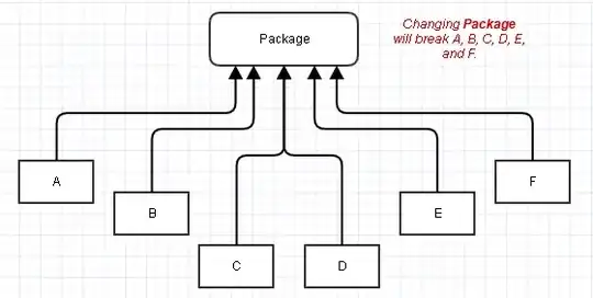

Difficulty of Change: Efferent Coupling
Code that's reused by a lot of places (ex: the public interface of a widely-used class, the signature and return of a widely-used function), is always going to be difficult to change, since changing their design breaks everything using their design (rippling/cascading need for changes).
For example, at a basic level, this package (design):

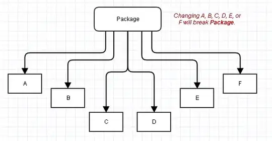

... is going to be difficult to change. This package (design) generally wouldn't be anywhere near as difficult to change:
It sounds to me like a lot of your code fits more in the second kind of diagram, and that kind of code tends to be easier to change without breaking external dependencies.
