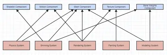

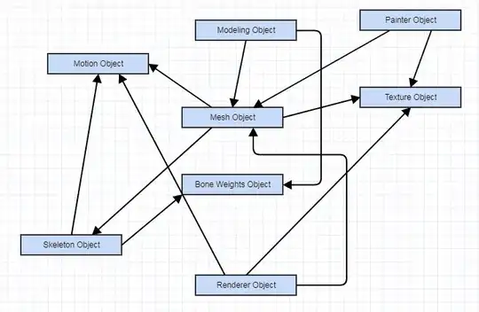

With game design, the overhead of 1000's of function calls, and event listeners can sometimes make it worth it to have classes that only store data, and have other classes that loop through all the data only classes to perform the logic.
IMHO there often aren't enough classes like this in heavily object-oriented systems. I need to carefully qualify that.
Of course if the data fields have wide scope and visibility, that can be extremely undesirable if there are hundreds or thousands of places in your codebase tampering with such data. That's asking for trouble and difficulties maintaining invariants. Yet at the same time, that doesn't mean that every single class in the entire codebase benefits from information hiding.
But there are many cases where such data fields will have very narrow scope. A very straightforward example is a private Node class of a data structure. It can often simplify the code a great deal by reducing the number of object interactions going on if said Node could simply consist of raw data. That serves as a decoupling mechanism since the alternative version might require bidirectional coupling from, say, Tree->Node and Node->Tree as opposed to simply Tree->Node Data.
A more complex example would be entity-component systems as used often in game engines. In those cases, the components are often just raw data and classes like the one you've shown. However, their scope/visibility tends to be limited since there are typically only one or two systems that might access that particular type of component. As a result you still tend to find it quite easy to maintain invariants in those systems and, moreover, such systems have very few object->object interactions, making it very easy to comprehend what's going on at the bird's eye level.
In such cases you can end up with something more like this as far as interactions go (this diagram indicates interactions, not coupling, since a coupling diagram might include abstract interfaces for the second image below):
... as opposed to this:
... and the former type of system tends to be a lot easier to maintain and reason about in terms of correctness in spite of the fact that the dependencies are actually flowing towards data. You get much less coupling primarily because many things can be turned into raw data instead of objects interacting with each other forming a very complex graph of interactions.
