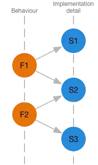

In graphical form
A diagram showing function 1 calling sub 1 and 2, while function 2 calling sub 2 and 3
Where do you drop the tests?
  • Testing F1 and F2 only will yield redundant tests for S2.
  • Testing for S1, S2, and S3 will not test for the behaviour of F1 and F2.
