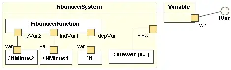

  • Composite Structure Diagrams – describe the structure of composites. It can be used to describe data structures, or even the interaction points of a function. Wikipedia shows a diagram for the Fibonacci function as an example:
    Composite Structure Diagram for a Fibonacci funciton
    Source: https://commons.wikimedia.org/wiki/File:Composite_Structure_Diagram.png
    In a sense, this would be the functional programmers choice rather than a class diagram, but this seems horribly overengineered….
