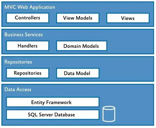

I'm wondering how do I treat the part of my application which is used only for monitoring my local network and storing the information in a database.
Several architectures implement such code differently, but in a layered architecture, you would need to create layers, e.g. DataAccess layer, Business logic layer. etc..
Your Model (there are different types of models) will interact with these layers as required, it all depends on your application or software architecture really.
Do I bend definitions of non-UI elements and try to figure out whether they could fit to either Model or Controller ?
I would say your "non-UI elements" is actually your business logic that needs to go in Model which then can interact with different layers e.g. DB layer etc..

  • That's a very good clue, thanks! After reading a lot more about it I'm still a little confused as to how models should be split. The View, Domain, Data models seem to encapsulate the same information, unless the app grows to be moderately large. Would it be valid to have only one model for smaller size web apps? Is there any particularly good explanation you could recommend? – Voy Nov 06 '15 at 12:37
    I added links to few projects that will def going to help you, new developers often get confused when they see duplicate code in OOP but most times its there for a good reason, smaller size web apps will grow - you never know.. so I would recommend follow a famous architecture which meets your goals most and slightly change it IF you are confident to do so, other then that it's a never ending debate when it comes to application design. – Muhammad Raja Nov 06 '15 at 14:12
