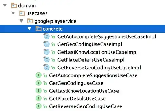

I've separated interfaces from their implementations by different packages, it's just add clarity, the separation is good looking and it is easier to navigate the project structure. I like it. The only point which confuses me - I've started thinking I might overdo stuff. So the question is - do you think it's a good practice to split code like that?

1@Panzercrisis this one is about project structure, it's not like I'm asking if I need to have those interfaces, of course, I need them. The one gnat pointed to is about a creation of an interface if you have only one implementation. – Eugene Jul 10 '15 at 12:45
You may want to edit the question to use an example where the interfaces are getting reused. – Panzercrisis Jul 10 '15 at 12:46
1@Panzercrisis it's evident I wasn't clear with my question, I tried to rephrase it. – Eugene Jul 10 '15 at 12:50

I think it is fine, and I do it.
However I would flip it from how you are doing it, the *impl
on every class would drive me insane. Instead I would name the interfaces differently (IThing
as I am .Net type) and have them in an Interfaces folder. Then the concrete class (Thing
) is 'normal' and would not need to live in a concrete class folder, just wherever made sense.
In some cases I then publish the interfaces folder as a Contracts
package for other things that want to work with my main types.

I actually prefer
IThing
too, but you may want to consider the consistency tradeoffs. Often, I change my coding style a little bit to keep things looking similar to other programming in my current language, and it may be difficult to avoid seeing other "Foo, FooImpl"s in imported Java code. – Katana314 Jul 10 '15 at 13:19
