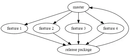

Instead of deriving from the development branch, I found deriving from master and merging into disposable "release-package" branches lead to less headaches.
Diagram for my proposed branch model
When merge conflicts arise in master->feature merge, the person doing the merge is the one most suited to resolve them. She knows the code and what it should do, it's her feature.
Features are streamlined into disposable release branches that can be deleted and reformed at any time. If a feature is not ready to go live by the release deadline, we can delete and recreate the package without it.
Development is only done in feature branches. Release branches only receive merges. If features conflict in a meaningful way, we should question if they should be merged into one another or scheduled for sequential release, one after another. In the case we merge two features into one another, the scenario might look too similar to NVIE's branch model, but here we are given a choice to do it or reschedule the features and recreate the release package.

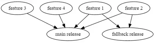

The disposable nature of release branches and the independence of feature branches makes it possible to stage fallback releases.
Fallback release diagram
If all four features don't stabilize until the deadline, only 1 and 2 go live.
Is my proposal a suitable branch model?

  • The idea of the dev branch is not to merge into it unless your feature is finished. The problem with your model is your feature branches dont branch from the release branch you want to merge them into (although git is kind about that sort of thing) – Ewan Jul 02 '15 at 07:53
  • I saw that model, in it, develop is the new trunk and master is a "QA" branch. That model still works for you, but feel free to use master as the trunk and create a new 'QA' branch between master and releases. – gbjbaanb Jul 02 '15 at 09:47
  • @gbjbaanb master is not QA. Only code that is already in production goes to master, and only after a release cycle that does not result in a rollback, so code is guaranteed to be safe for other developers to branch from. That's the whole point: prevent branching or merging from a failed release package. – Juliano Jul 02 '15 at 13:50
  • @Ewan You say git is kind about that, are there any side-effects nonetheless? – Juliano Jul 02 '15 at 14:10
  • it just makes your life harder.@Idan hits the nail on the head though. at some point you have to pick some features and merge them, and that merge might break stuff. – Ewan Jul 02 '15 at 18:33

The main problem you are going to face is that when you are combining the feature branches to a release branch, you'll need to solve all the inter-branch conflicts. Merge conflicts are the easier ones, since they pop when you are merging specific branches and you can ask the branch owner to solve them(it's far from ideal though, since the branch is not fresh in the owner's memory). But not all conflicts pop us as merge conflicts - some create compilation errors or runtime bugs, and it's not as trivial to figure which feature branches have caused those.
A possible solution can be to shorten the release cycle - adding more rapid "sub-releases", e.g. twice a week. This will limit the number of feature branches you are merging on each sub-release, which in turn limit the conflict potential. This, of course, comes with it's own problems - a frequent release overhead, where the release master needs to choose which features to merge in each sub-release, and after the sub-release the developers need to merge/rebase their pending feature branches(and resolve conflicts).
At any rate, I think your fear of branching-from-develop is unjustified. You are portraying develop as some big playground where all developers push their unfinished scrabbles of untested code - and it's not true. The feature branches fulfill this role. develop, while it might not need to be as stable and as rigorously tested as master, should still have a certain level of stability - the primary rule is not to push to develop if it'll prevent the other developers from continuing to develop even if they merge/rebase develop to their feature branches.
This essentially means that you don't merge a feature branch to develop unless it passes automated tests(doesn't have to be the full suite - if you have a 10-minute suite that catches most bugs and a 5-hour suite that catches even the rarest of bugs, test the feature branches with the 10-minutes suite), so it should be OK to merge it to develop.
Note that master still needs to pass the 5-hour suite, and you have no guarantee a a merged feature branch won't break the 5-hour suite - but neither does your model provide such guarantee. The point is that even if a merged feature branch does break the 5-hour suite - it's still a branch you want in the next release(otherwise you wouldn't have merged it to develop), and the solution is rarely to exclude the feature from the next release.
