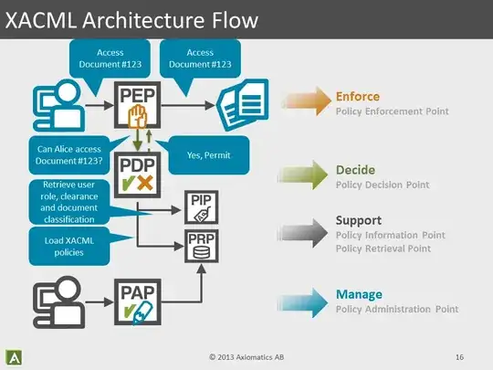

XACML is the solution you are really looking for. It is a type of rules engine that is focused on access control only. XACML, a standard defined by OASIS, defines three parts:
  • an architecture
  • a policy language (which is really what you want)
  • a request / response scheme (how you ask for an authorization decision).
The architecture is as follows:
  • the Policy Decision Point (PDP) is the core part of the architecture. It is the component that evaluates incoming authorization requests against a known set of policies
  • the Policy Enforcement Point (PEP) is the piece of code that protects your application / API / service. The PEP intercepts the business request, creates a XACML authorization request, sends it off to the PDP, receives a response back, and enforces the decision inside the response.
  • the Policy Information Point (PIP) is the component that can connect the PDP to external sources of data e.g. an LDAP, a database or a web service. The PIP comes in handy when the PEP sends a request e.g. "Can Alice view doc #12?" and the PDP has a policy that requires the user's age. The PDP will ask the PIP "give me Alice's age" and will then be able to process the policies.
  • the Policy Administration Point (PAP) is the place where you manage the entire XACML solution (defining attributes, writing policies, and configuring the PDP).
eXtensible Access Control Markup Language - XACML Architecture
Here's what your first use case looks like:

You can read more on XACML and ALFA from:
What you really want here is XACML. It pretty much gives you exactly what you want. You don't necessarily have to implement the full architecture with all the roles being completely separated... if you only have a single application, you can probably get away with integrating the PDP and PEP into your app with balana and the PIP is whatever your existing user database is.
Now, anywhere in your app you need to authorize something, you create a XACML request which has the user, the action, and the context, and the XACML engine will make the decision based on the XACML policy files you've written. These policy files could be kept in the database or on the filesystem, or wherever you want to keep the configuration. Axiomatics has a nice alternative to the XACML XML representation called ALFA that's a little easier to read than the raw XML, and an Eclipse plugin to generate XACML XML from ALFA policies.
