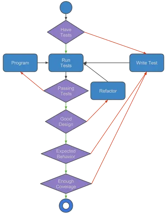

I found a TDD flowchart and converted it to a Google Drawing. I'm using NUnit. I have studied TDD, know what it is and practiced it somewhat. This flow chart is for TDD only; no steps before Unit Testing are included.
enter image description here The flowchart starts out with "Write Test". I had my concept, nothing I had read said I needed anything else first, so I tried following the flow chart. It was too much of a leap to go from "foggy notion" to Unit Test. This caused me "designer's block". Then I read someone say "just do it!" I tried that, but the resulting tests and ensuing code wandered somewhat aimlessly since there was nothing to guide what tests to write.

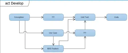

SpecFlow starts with a verbal description of a "feature" and creates tests that NUnit can run; they don't look like the unit tests I created manually but maybe I'll figure out how they relate to one another.
Use cases helped me get convert the initial foggy notion into a formal description, which was a bit of sunshine. I used Visual Studio 2013 for that. I don't see any facility (in Visual Studio at least) to convert my use case into Unit Tests, although I found some evidence that this is one purpose of a use case. Quoting from the UML User Guide, 2nd ed., p.246:
A use case diagram can be forward engineered to form tests for the element to which it applies.
And it looks like Visual Studio maybe wants to convert it because it can store template data on the use case and has "Code Generation Settings"
Here is a picture of what I have tried so far enter image description here

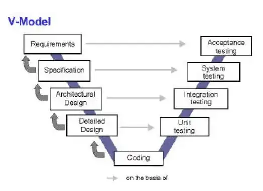

You cannot jump directly from "idea" to "implementation". Good example is the "V model" : enter image description here
You start at high level go lower and you write tests on each level. And each level gets more specific in both implementation and testing. For example you write an acceptance test that says that you should be able to add a customer. This results in you writing an integration tests to ensure client can be both created and inserted into database. And this forces you to write unit tests that describe detailed conditions for creating and saving the customer object. And then you implement the code until unit test pass, this will make integration tests pass and that will make acceptance tests pass. So you get few high-level acceptance tests, more integration tests and lots of small and detailed unit tests.
