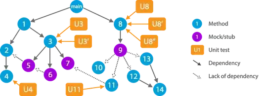

Imagine the following diagram which represents methods calling other methods:
Unit testing can be represented this way:
For example, unit tests U3 and U3′ are not affected by bugs in method 6, because it is replaced by a stub. Nor is it affected by the regressions in method 2, because the stub 5 doesn't rely on method 2. In the same way, U8″ doesn't care about method 7, because 9 is a stub and doesn't rely on 11 which in turn uses 7.
Imagine you make a commit and your CI informs you that U8′ now fails. Where would you search for the problem?
  • In U8′. Maybe the code it tests is correct, but the test is not. This happens, for instance, when requirements change: you change the code but forget to reflect the change in the tests.
  • In method 8. There could be a regression.
  • In stub 9. Maybe you implemented a change in code and in tests, but forgot to change the stubs.
On the other hand, you are sure the problem is not with method 11 or method 7.

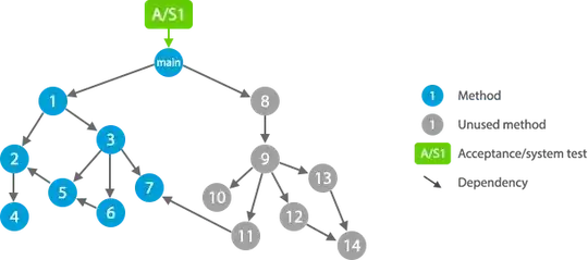

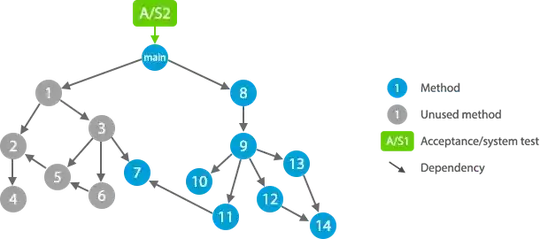

Now this is how acceptance or system tests would look like:
Imagine you make a commit and your CI informs you that A/S2 failed. Guess where is the problem? Much more difficult, isn't it.
Obviously, another aspect is that, as I described above, a small change can cause many acceptance tests to fail. For instance, a regression in method 7 may lead to A/S1 and A/S2 to fail. With unit tests, a regression in method 11 may cause U11 to fail, but will not affect, for instance, U8.
