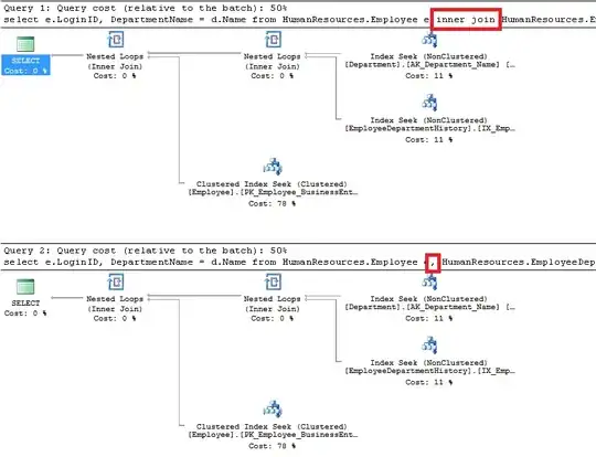

Performance
This is most definitely going to be RDBMS-dependent. I can only speak on behalf of Microsoft SQL Server. Performance-wise these are equivalent. How do you know? Capture the post-execution plans and see what exactly SQL Server is doing for each of these statements:
In the above image, I highlighted that I'm using both queries as above, differing only in the explicit characters for the join (JOIN vs ,). SQL Server does the exact same thing.
Summary
Don't use commas. Use explicit JOIN statements.
