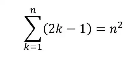

It's a way more mathematical approach and so you may like it or you hate it. But here we go:
If you're not familiar with the sigma operator in mathematics, this is how it works. It's simply a 'for' loop, with 'a' being the starting value and 'b' being the included upper limit. It increases 'a' every 'iteration' by one and sums the values together.
So mathematically, your problem could be written like this:

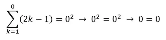

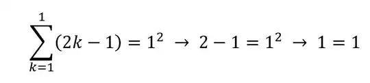

Now, for mathematical induction to work, we first have to prove that this statement is true for the lowest value of 'n' (this would normally be 1, but 0 works here as well):
Which definitely is true.
And thats true as well.
