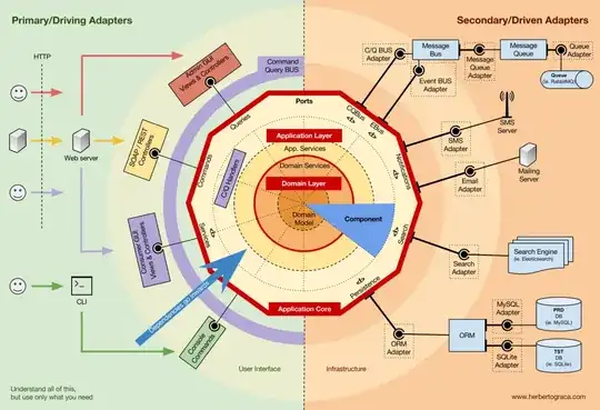

I like following drawing of hexagonal architecture from article DDD, Hexagonal, Onion, Clean, CQRS, … How I put it all together:
In this high level view of the whole system it's visible, there are parts (APIs) of multiple different frontends to the application. Therefore controllers should be as thin layer as possible, and be doing only bare minimum to provide access to application in required form.
